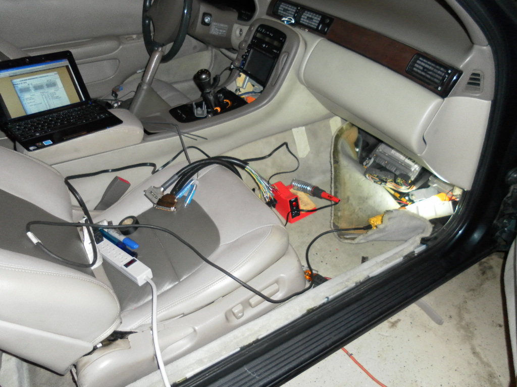

Phase 1 of the MS3 install is done. All I did was install all the wires that were "tapped" into the existing wires (meaning I didn't do any of the wires that required me to cut them). This was simply so the car would still start and be running completely on the stock ECU, but the MS3 should turn on, and I should be able to play in the software. Here's some pics:
Work area setup
Wires tinned
Soldered, heatshrinked/elec taped
Quality Inspection performed by Freckles
Dangling for the time being. This is where it'll be mounted however. Not completely hidden, but out of the way for the most part, and easily accessible if need be which was my goal. You can see the strips of masking tape with little dots on them. That is where it will be once it's installed permanently:
And last but not least, a little startup vid. Like I mentioned before. I'm trying to go 1 by 1 with the car here. So since everything I hooked up so far was non-intrusive so to speak, all I'm doing here is making sure that I didn't mess anything up while I was down there, and that the car starts up with no problems and there's no magic smoke coming out from anywhere
