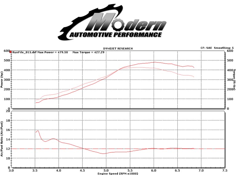

479whp ~ 427 ft/lbs on OEM Longblock!
MAP '93 Eagle Talon (Alex Wolner)
OEM 6 Bolt Shortblock
OEM Intake Manifold
OEM ECU
2G MAS
Crower 414 Cams
SC61 Turbo
SAFCII
28 psi on E85 fuel
