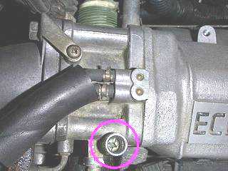

and here is the biss screw

Isn't this going to be completely different because it is an RS? The 420A only has an adjusment screw for the throttle cable if I recall correctly.
Hence which is why, when posting a tech question, all the info should be posted too.

i figured the name would give away all the info ppl needed. its a 97 rs, non turbo 420a. sorry for the confusion.

yeah sorry man. my fault i just kinda assume everyone has a gst or gsx...so yeah its completely different
