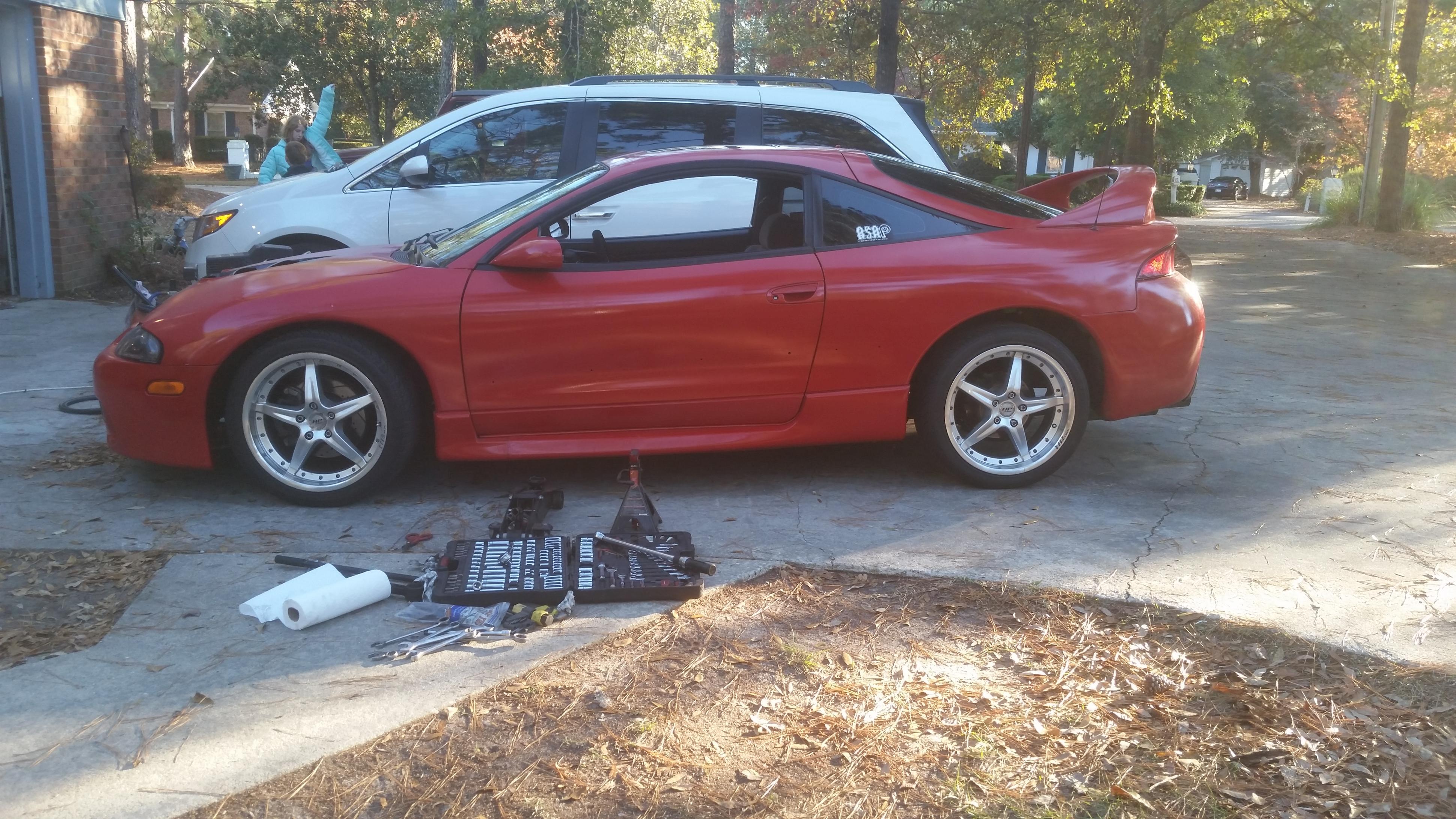

Also here you can see how much lower the LCA made the front.
