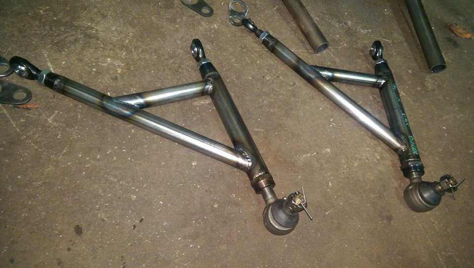

Are the control arms a lot stronger with the ball joint receivers over just using the threaded ball joints.
The short answer is YES. I cannot tell you by how much, but I would not be comfortable using what you have in those pictures, at all.

Non-adjustable tie rod ends used as ball joints, plus no triangulation point at the joint itself. No thanks.

Those welded things look like they'd snap after one bad pothole.

Those aren't mine. That's what someone is building and selling along with a k-member, but it didn't seem like any of it was very strong

I second the fabricated lower control arms look a little sketchy at best.
Good there not yours! I will post up pics of mine once fabricated, it will take about a month. You will see a big difference.
