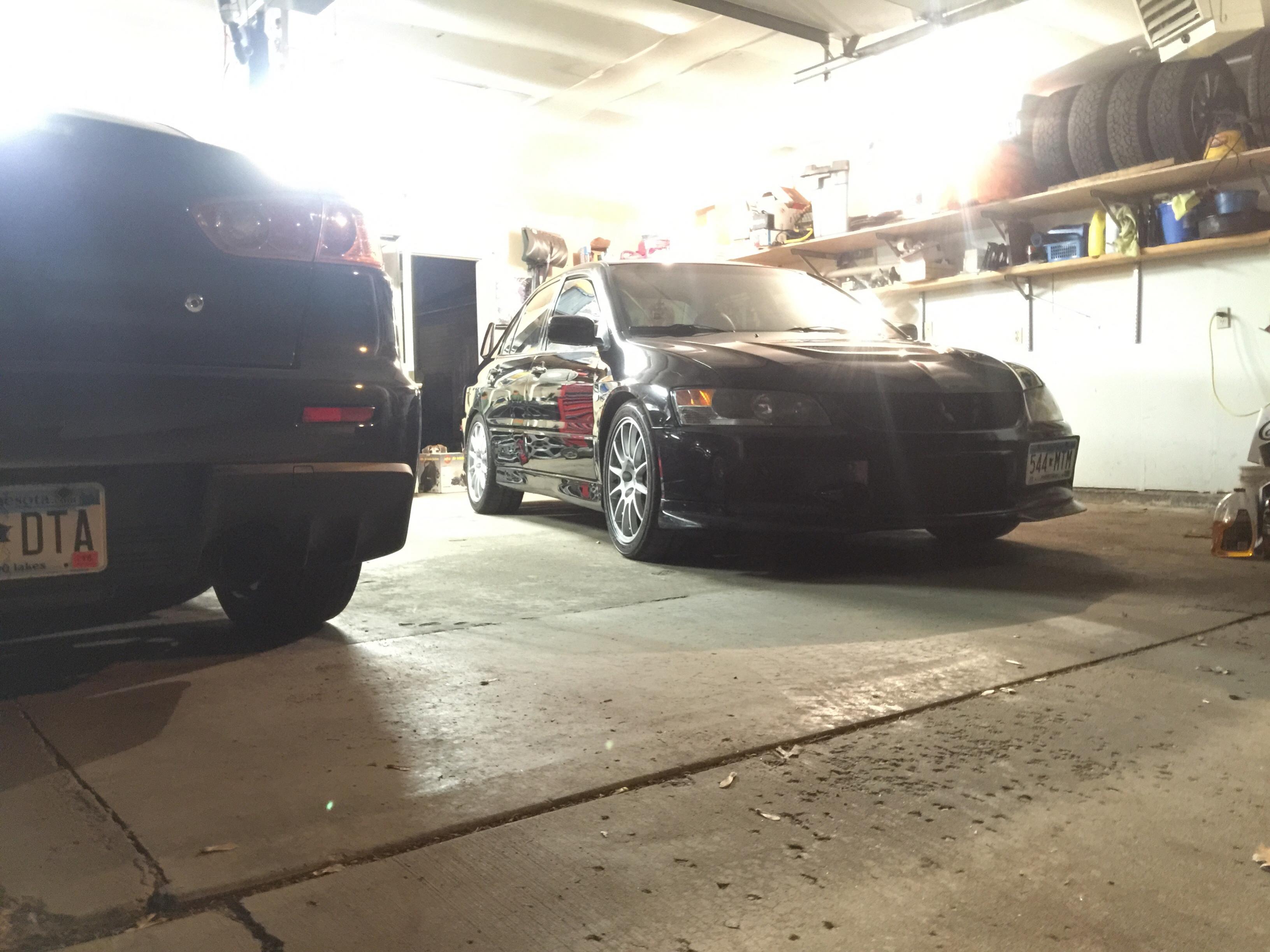

Dusted off, shined up, and ready to burn some corn at DCTC tomorrow night! Officially amped and ready to go fast!!
