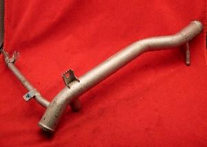

I think he meant the portion that connects to hoses 36/37 in that pic is blocked off.

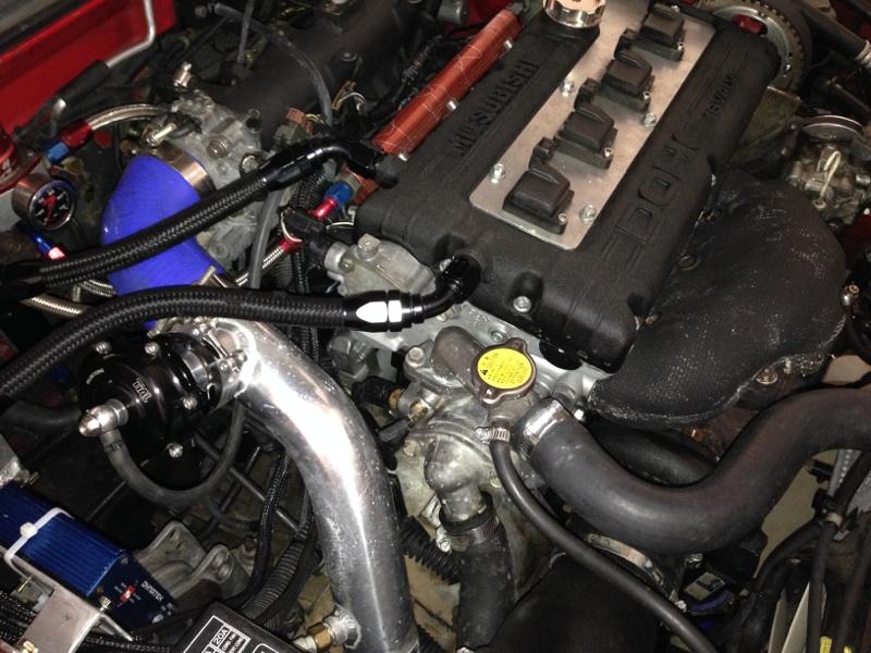

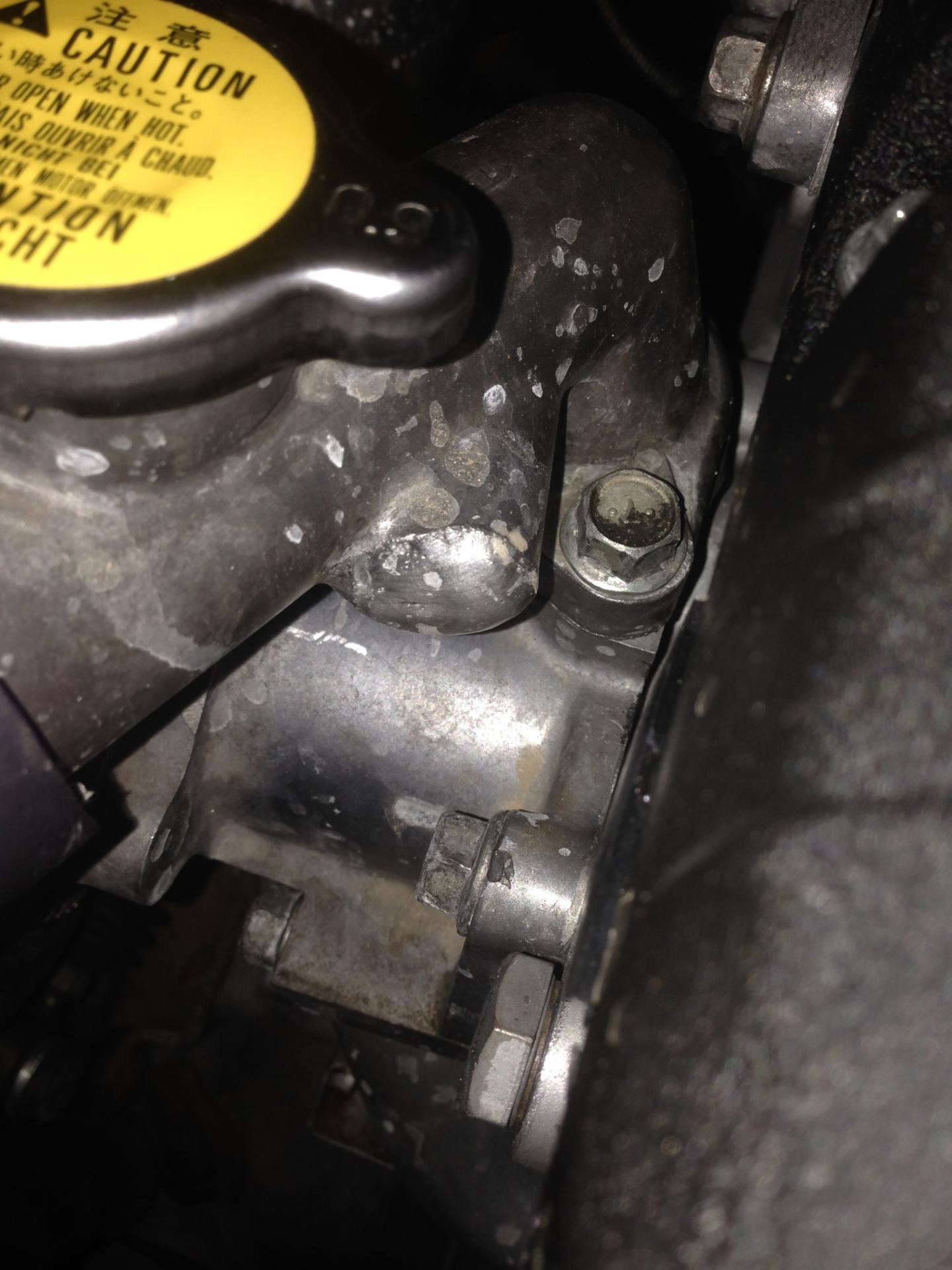

Here are the picts of what im talking about. And I haven't asked Shane Phillips personally but previous owner said shane did this to the car.

The end of the water pipe (red picture) is welded shut. The other picture is the weld of the thermostat housing that is actually on the car.
To be honest I havent even followed the coolant lines to see how its all done. Been so focused on tune issue. (I may talk like I multitask but reality is im pretty single minded till a task is done)
I have already inquired about replacing all the coolant system so its reverted back to stock and all the parts aren't even $120 from the guy in north carolina. this is on my to do list like stated several times.

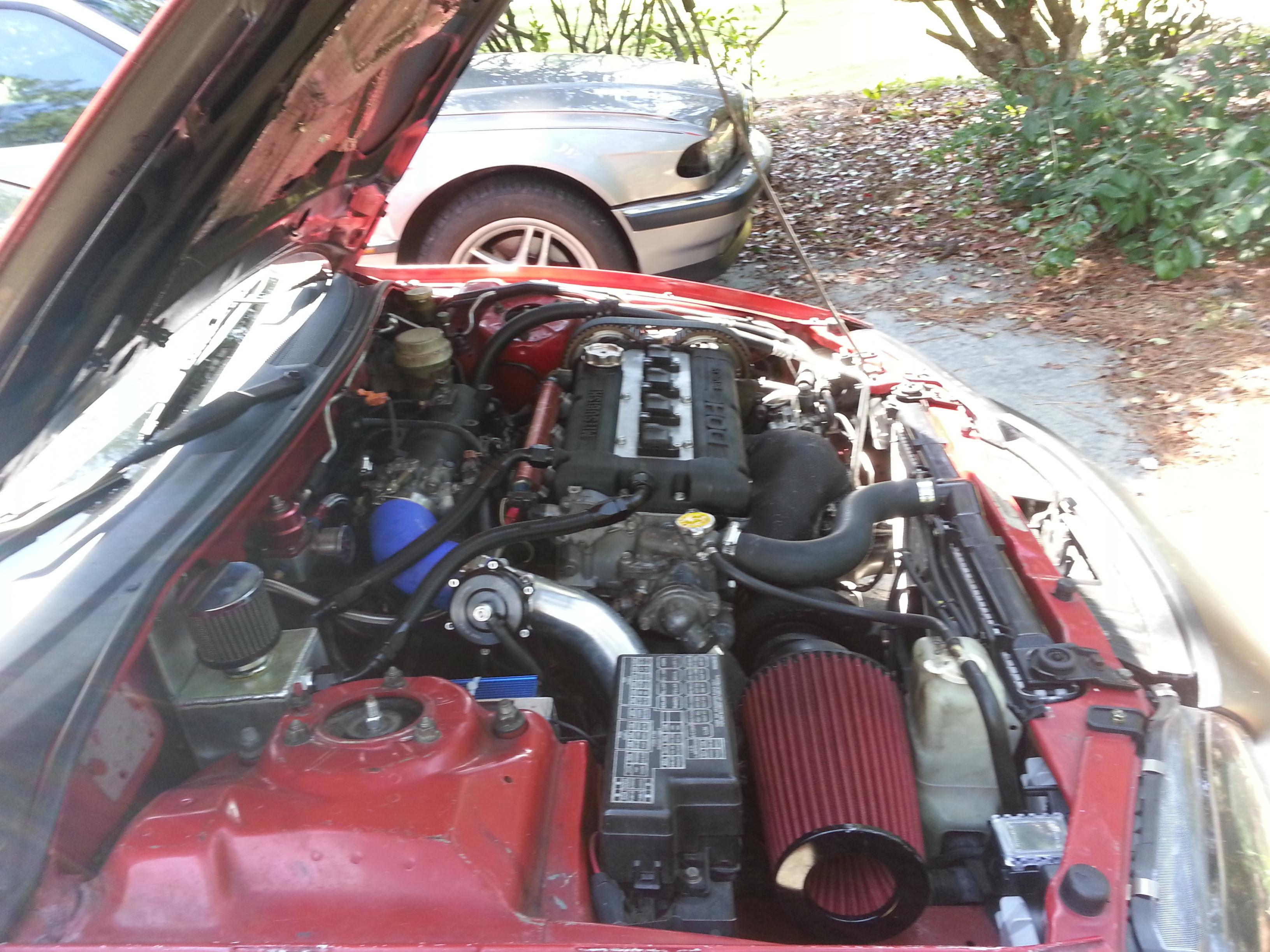

Here is the picture of the lower radiator hose... found a pict I took the day after I got it.

I must have clearly missed something here the thermostat housing in the diagram doesnt look anything like the one in the picture of my car? Or am i just not seeing it?
Is the one on my car from a different year or something?

what youve pictured is that the turbo water feed system is capped off. why? the holsets don't use water jackets.
this will have no bearing on the problems you're having whatsoever.
