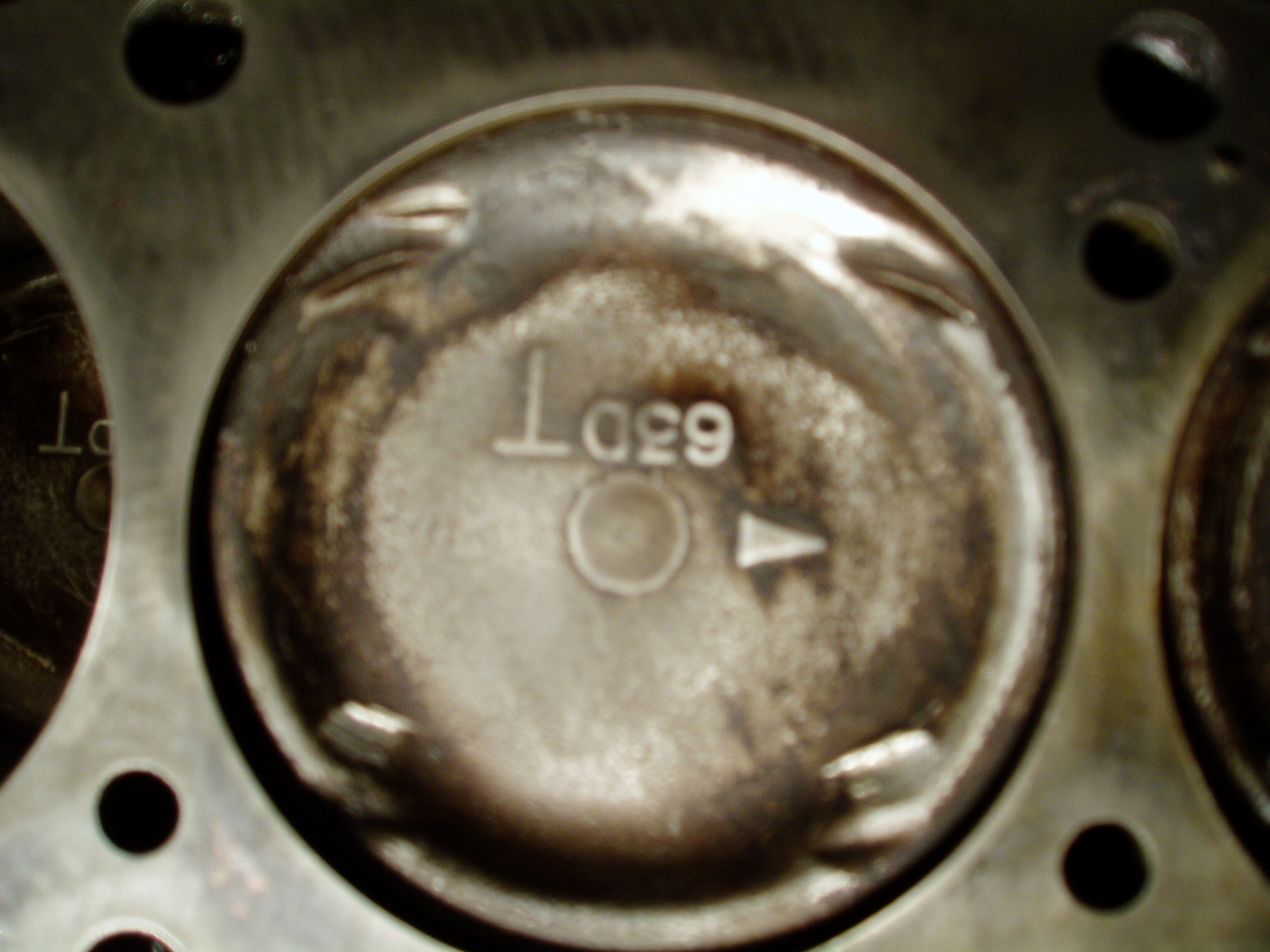

I have a 1991 eagle talon (2.0 turbo that the timing belt snapped and hit the pistons. I was wondering the exzact damage. I of coarse know that the head and timing belt have to be replaced however how does this affect the pistons. I can see where the valves hit them. Will this affect the engine afterwards?

It depends on how bad the pistons hit. Put up some good close up pictures of each piston. It will create a weak spot in the piston, if the car is only going to be pretty stock, they are normally ok with a light hit. You will want to file down and polis the lip that was created with the hit. It might be a good time to freshen the engine and put in some 2g pistons too.

please post pics of said damage. you might be fine. usually nothing super major happens but every once in a while you get some good chunks taken out

Well here they are!! Doesn't look like engine is damaged. You see all pistons, the broken head, and the new one

File down the pistons where they had contact with the valve. Other than that you'll be good to go.
What the hell is all over your engine bay? Looks like metal shavings or over spray...
Ya that was all the gunk that was left over from a junk head gasket that I had to grind off. Now I am just lining up everything to slip on the timing belt and the cams want to turn about 2 to 3 turns off of their mark. Is there a trick to keep the cams and the crank in the correct location while you get the belt and tensioner on correctly?

Wow, those valves hit the pistons pretty hard. I wouldn't reuse them, but I guess worst case scenario you have to redo the engine. Good luck!
