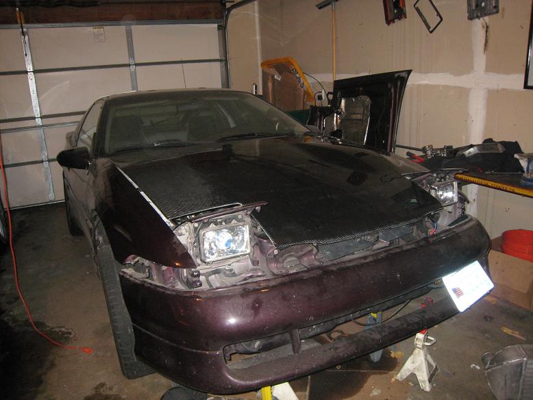

The new hood somewhat on.

Old 02-11-2008   #76
b00stcreep21
I hate everyone
b00stcreep21's Avatar
Join Date: Jul 2006
Posts: 938
Re: My Winter Upgrades
Oh snap, JDM fiber. Lookin good dude
Old 02-11-2008   #77
looks good
you need to get the carbon pop ups also
Old 02-11-2008   #78
That and I need some different rad fans since I had to remove one because the turbo gets in the way.
Old 02-11-2008   #79
Shouldn't need too much for fans with that radiator and E85.
Old 02-11-2008   #80
That's what I hear. Except I experienced a much different thing from that, while trying to keep my car from overheating all last year.
