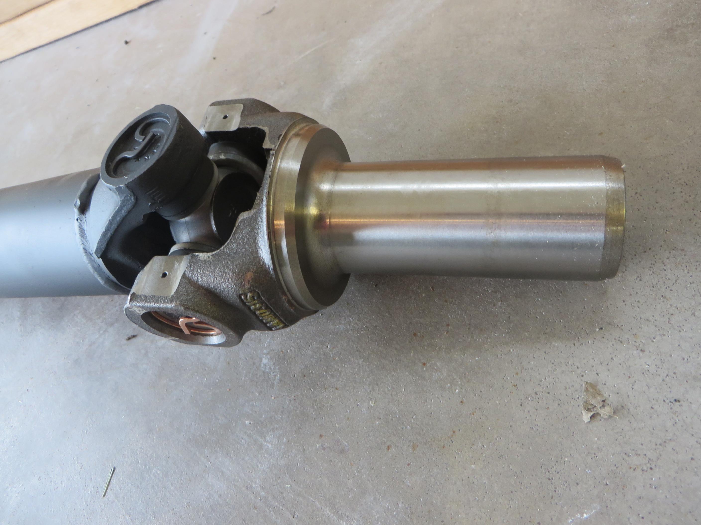

No big updates. But I did get a complete new driveshaft made to fit perfectly with my exact setup, so no more adapters or anything like that. Made from heavy duty wall .100" DOM with the CD009 slip yoke on front, Ford 8.8" Flange on the rear, and 1350 U-Joints. Fitment was spot on, and price wasn't bad ($420). TUrn around time was about a week from local shop AA Drive Line in Anoka. Same place that did the subframe bushing work for me a few years back. So good experience both times!

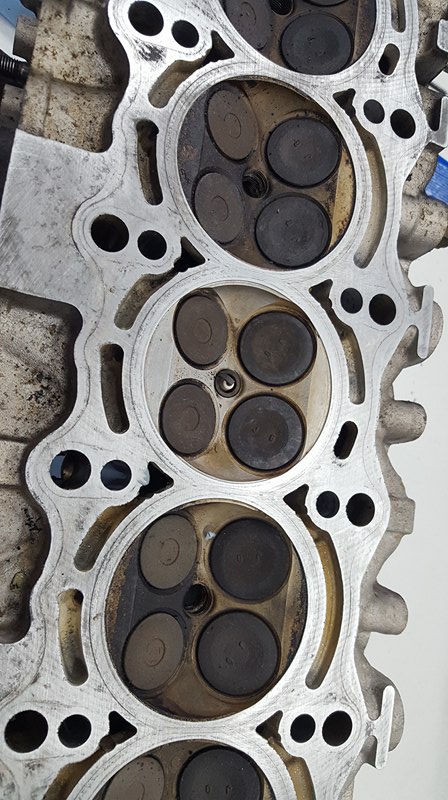

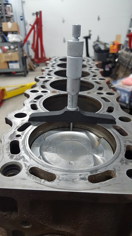

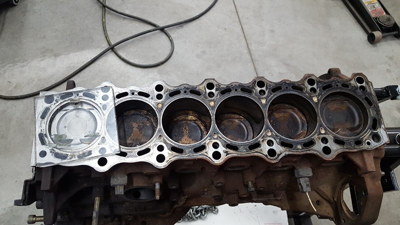

Work has started on the new motor. Couple things interesting worth noting.
Some Factory 2JZ-GE VVTi measurements he took:
- Head chamber volume 41cc
- Piston volume 9.5cc (he cc'd a set of GE non-VVTi pistons as well with a value of 8cc)
-Piston / Deck clearance 0.003" popping out of the deck (he temp installed a set of GE non-VVTi pistons/rods as well with same measurement)
- Head step down recess is 0.028"
All good info to help me decide exactly what we do with the build as far as how much we deck the head, what head gasket to run, etc.

Sweeeet, any idea what happened with your old motor yet?
My general advice is to always leave as much meat as possible. Machine all surfaces the least amount possible to achieve the surface finish or trueness you want. Don't machine just to machine if the surface is good as is.
Achieve your other goals with hg thickness, rod length, piston design etc.
This is the safest route long term.

No ideas on old motor yet.
Momin yeah a lot of these measurements are basically going to help me figure out which HG to use.

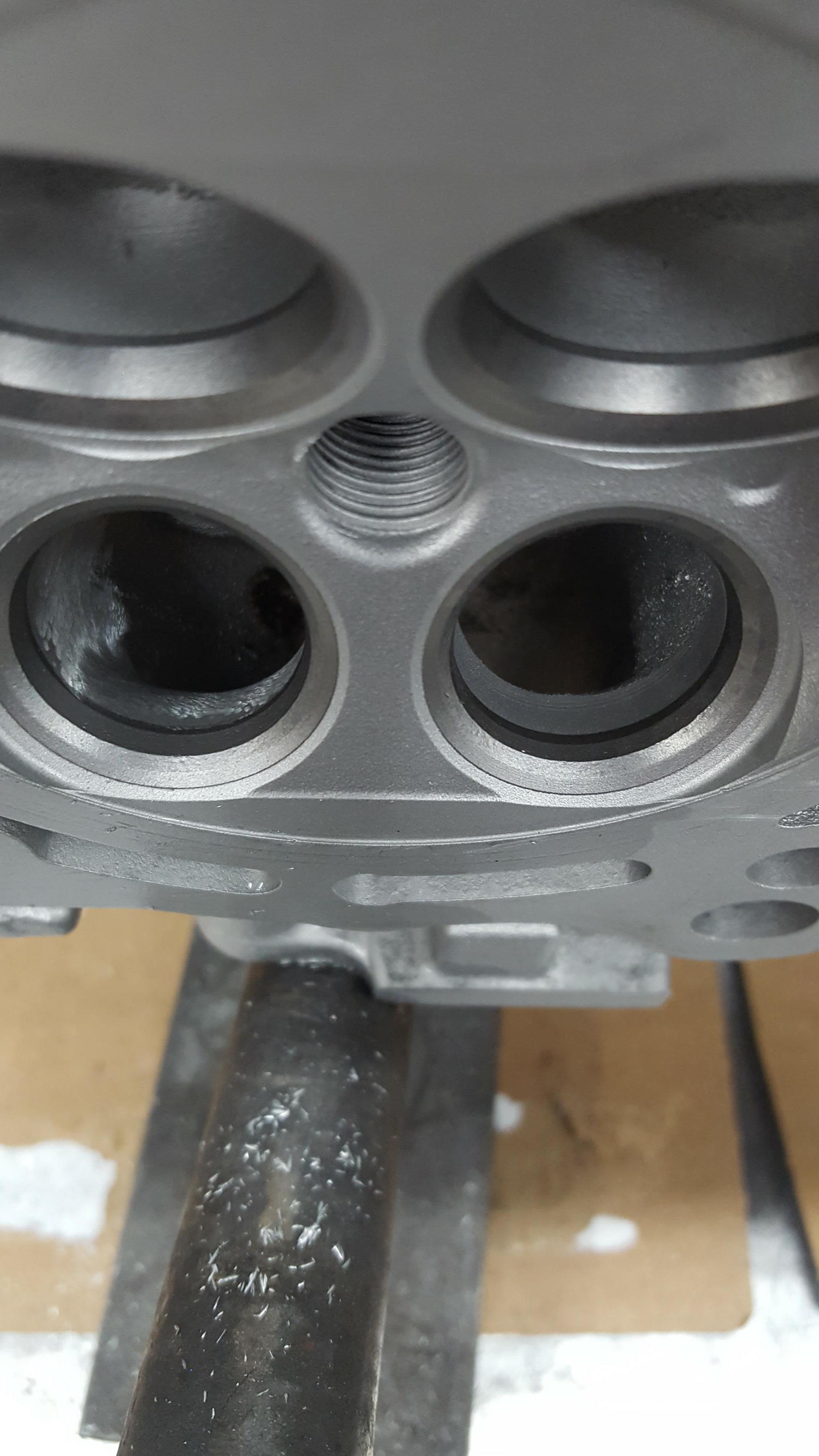

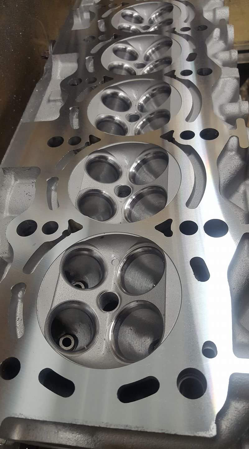

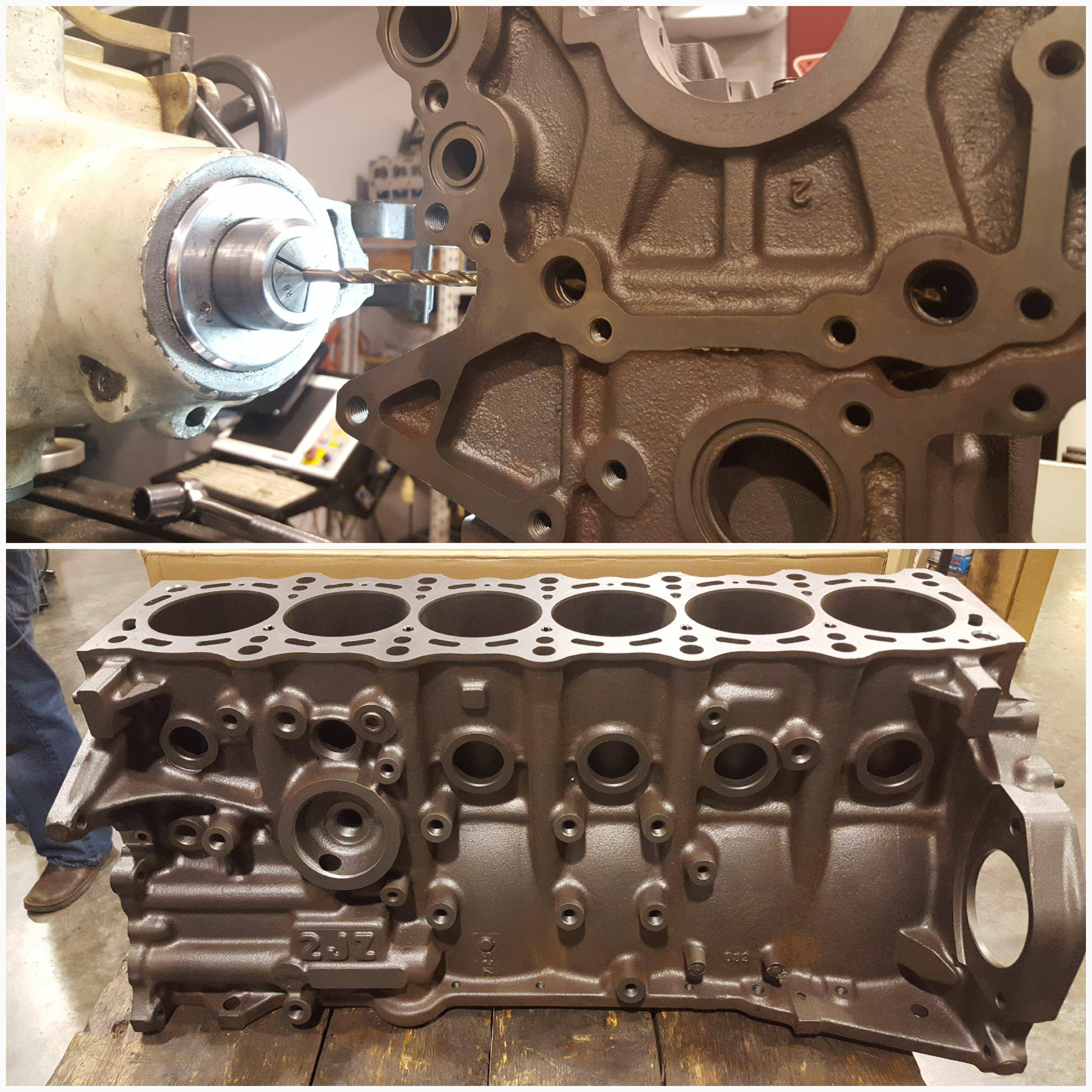

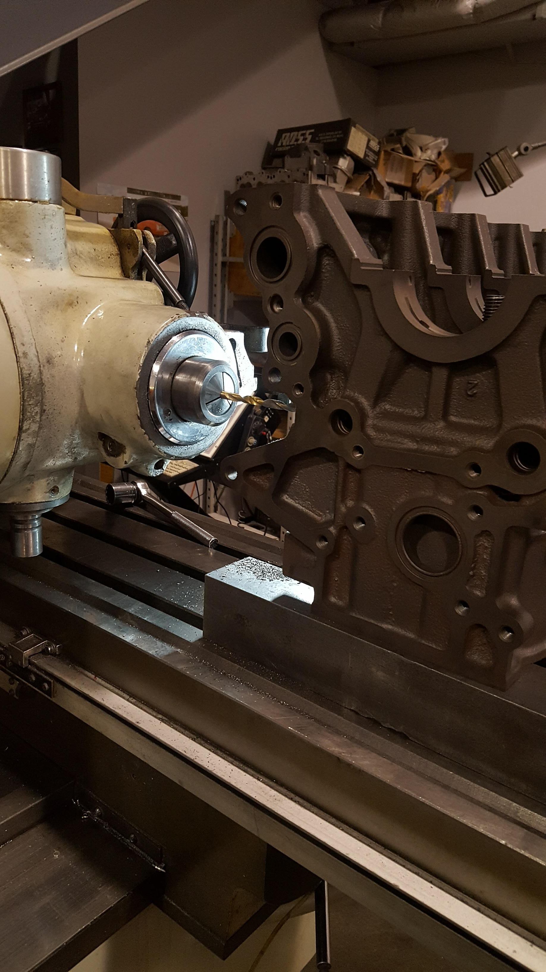

Motor work has begun. Took this 100k+ crusty ol motor and made it new looking again. He drilled a GTE style oil feed using the world's longest drill bit. Love the Supra idiots saying it can't be done. Welp it's done lmao. Also buttoning up the pocket port work on the head (before & after pics attached ).
