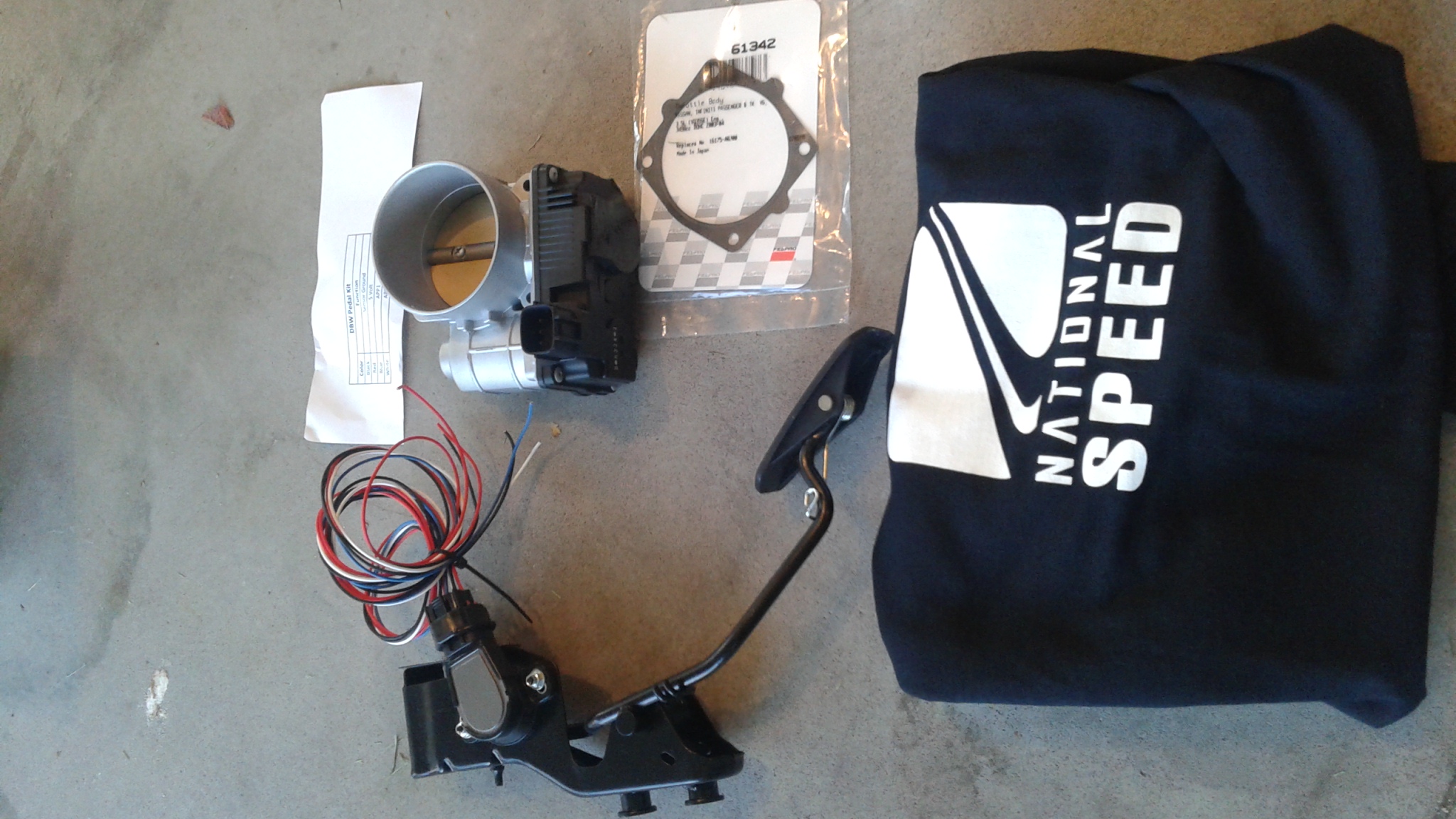

Got my new DBW kit in the mail. No more throttle cable for 2018! The TB is an OEM (refurb) 350z 3" TB.

Very cool! Any benefit to having it ported at all?
Old 10-20-2017   #1670
Re: Project Lex
Maybe, but I'm ok with 3" I'm still running 2.5" piping

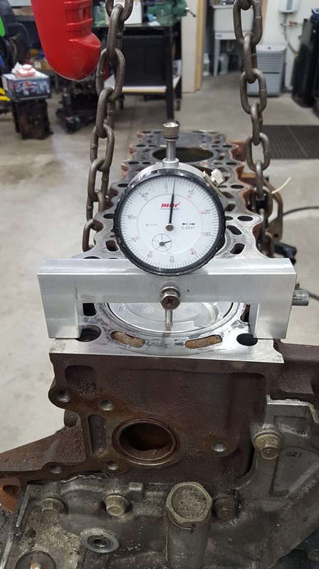

Work has started on the new motor. Couple things interesting worth noting.
Some Factory 2JZ-GE VVTi measurements he took:
- Head chamber volume 41cc
- Piston volume 9.5cc (he cc'd a set of GE non-VVTi pistons as well with a value of 8cc)
-Piston / Deck clearance 0.003" popping out of the deck (he temp installed a set of GE non-VVTi pistons/rods as well with same measurement)
- Head step down recess is 0.028"
All good info to help me decide exactly what we do with the build as far as how much we deck the head, what head gasket to run, etc.

My general advice is to always leave as much meat as possible. Machine all surfaces the least amount possible to achieve the surface finish or trueness you want. Don't machine just to machine if the surface is good as is.
Achieve your other goals with hg thickness, rod length, piston design etc.
This is the safest route long term.

Momin yeah a lot of these measurements are basically going to help me figure out which HG to use.

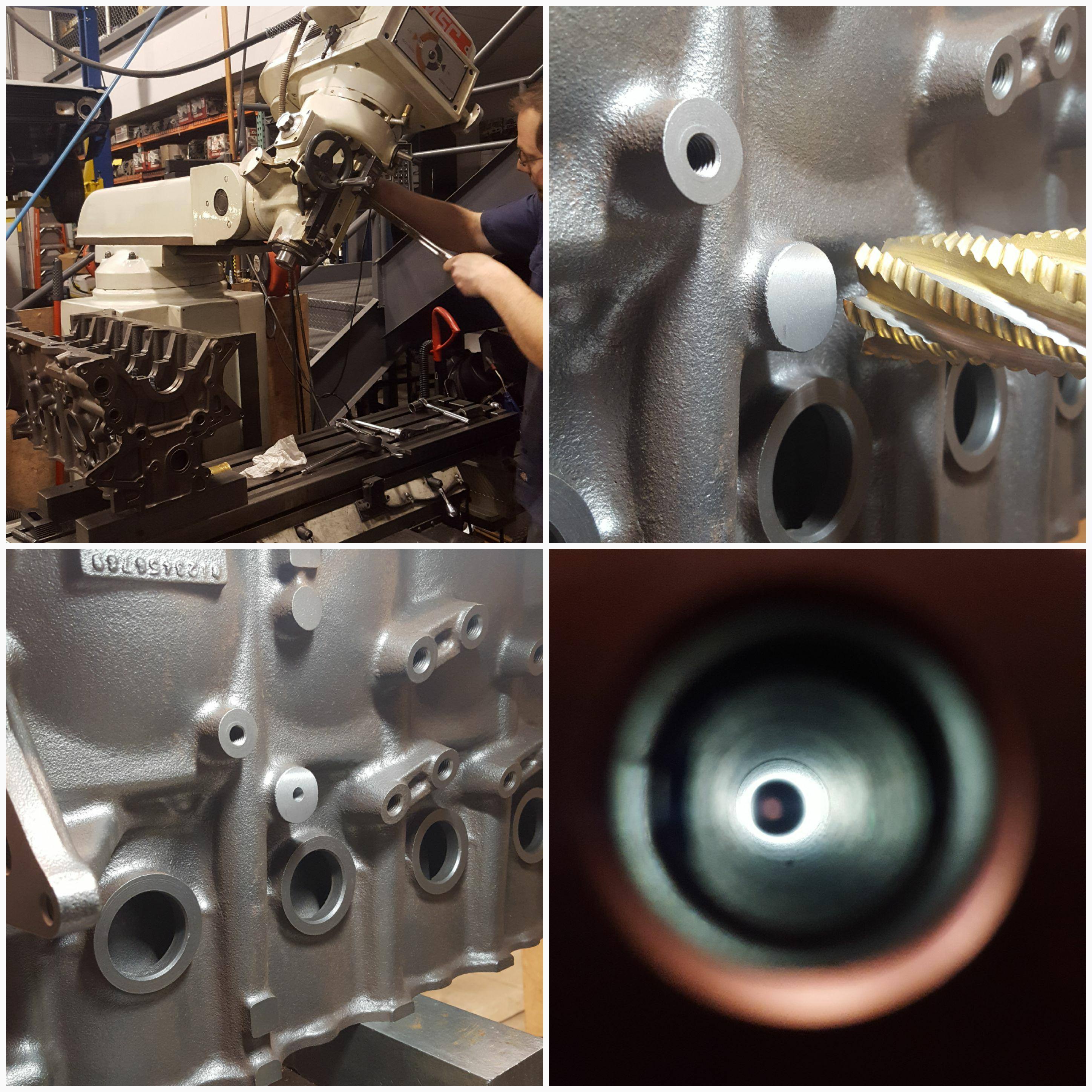

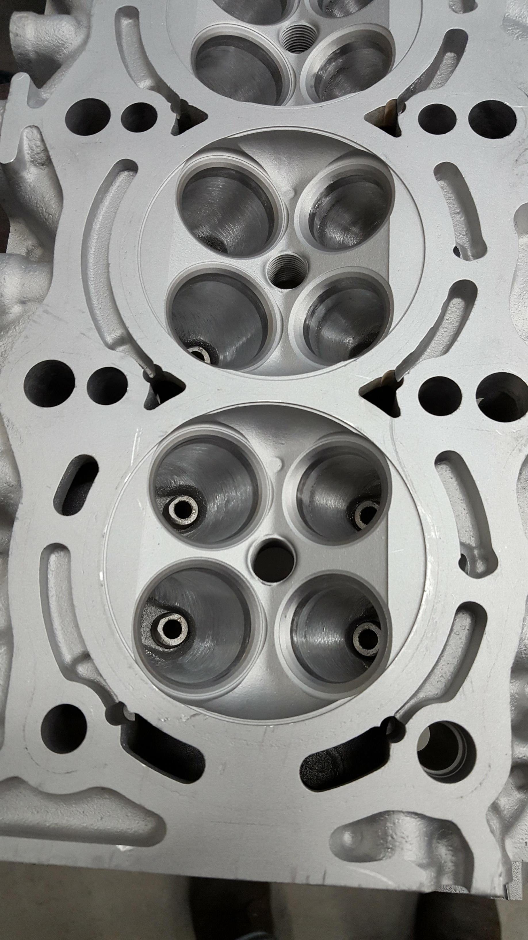

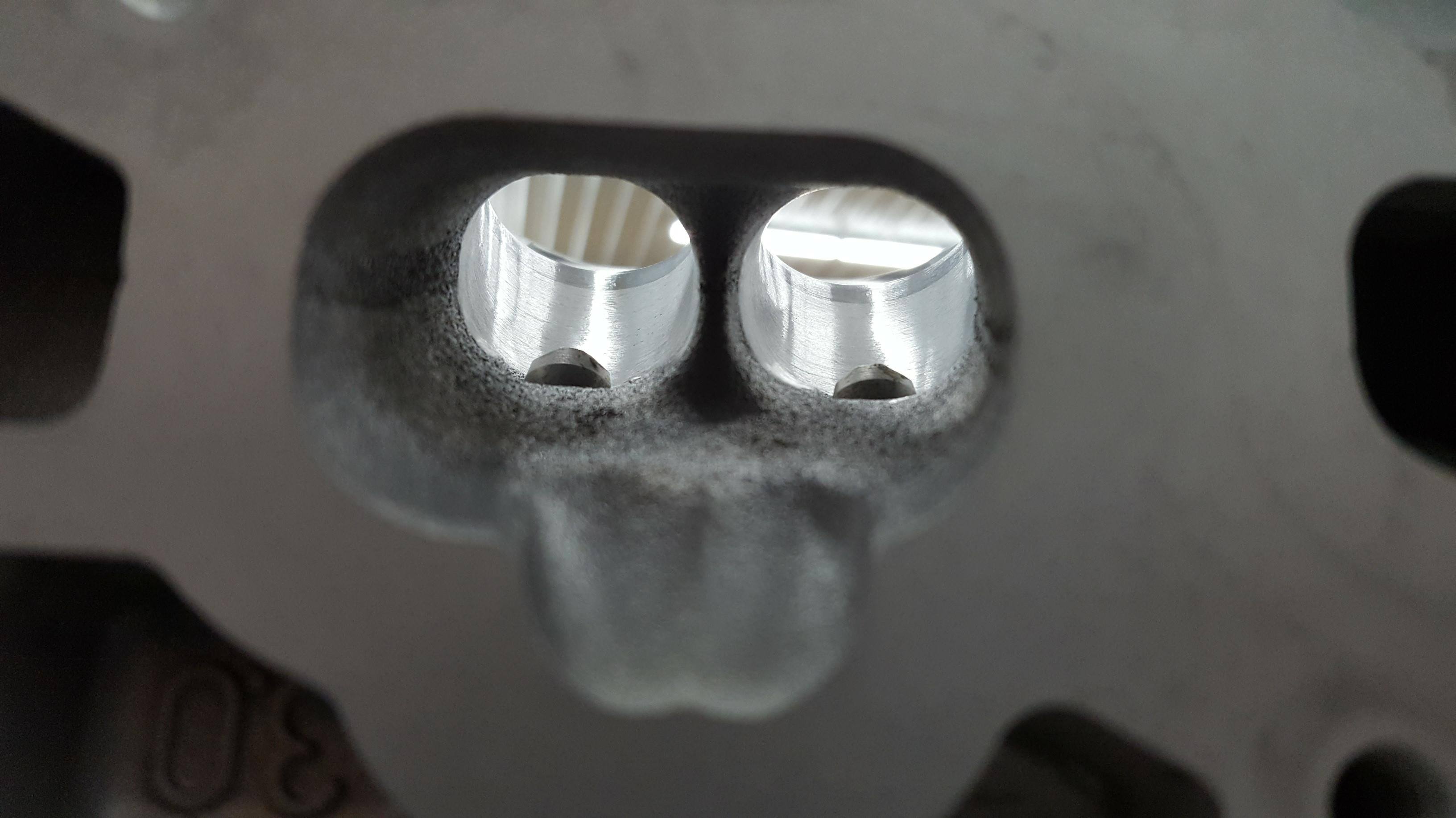

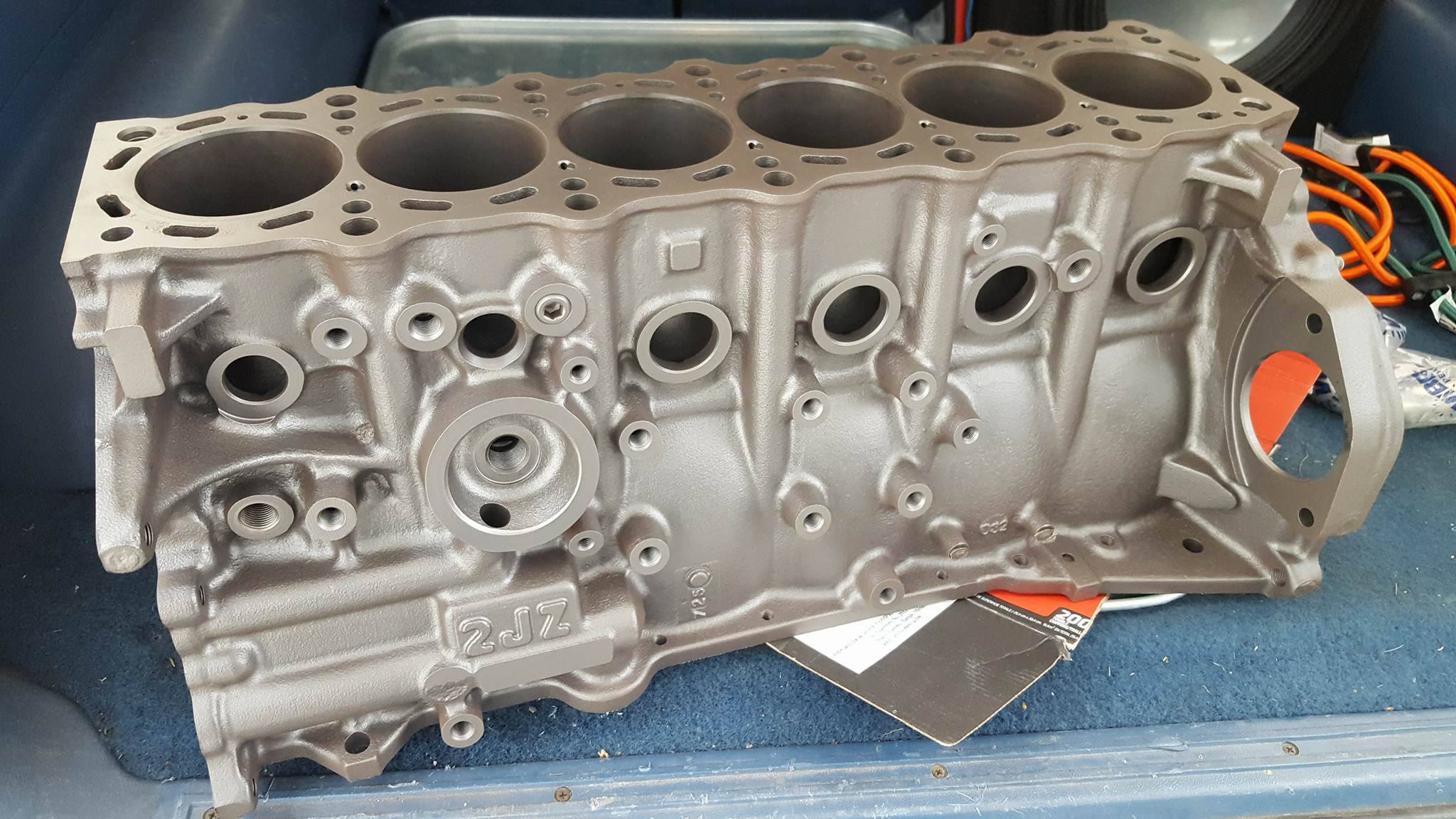

Motor work has begun. Took this 100k+ crusty ol motor and made it new looking again. He drilled a GTE style oil feed using the world's longest drill bit. Love the Supra idiots saying it can't be done. Welp it's done lmao. Also buttoning up the pocket port work on the head (before & after pics attached ).
