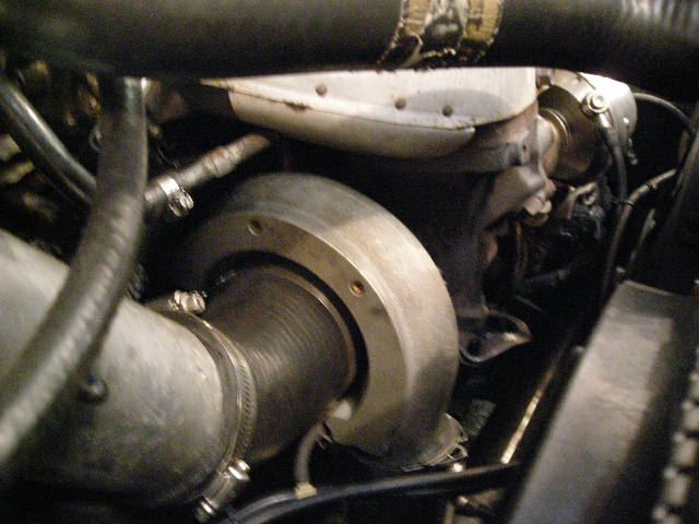

What I did to get the injen intake to fit my 20g is cut it up before the bend and put a 45 degree coupler the nessicary size on there so it was more open. Here is a photo.
Is the injen intake really 3'' all the way down until the bottom bend? My car is in storage otherwise I'd just go look. This sounds like a very simple alternative.
