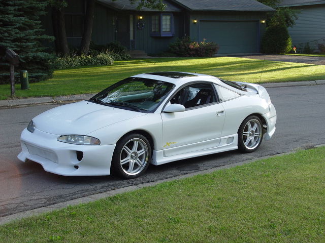

Here are some new pictures for you all.

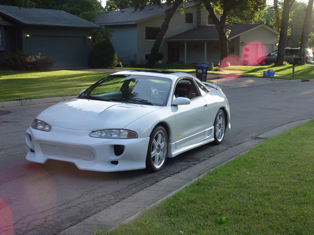

pict 2

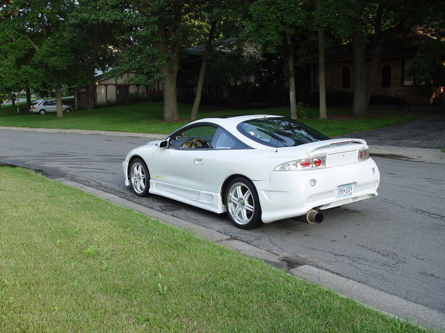

pict 3

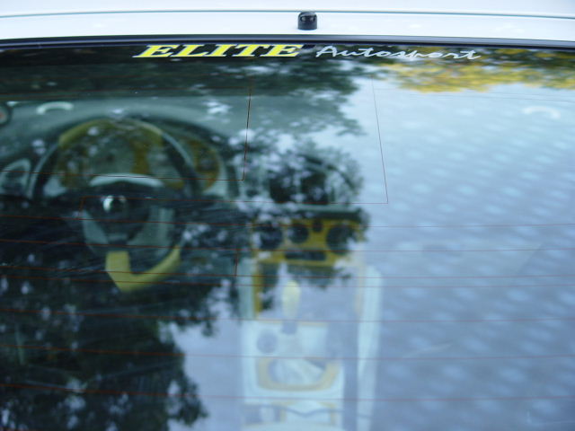

pict 4
File Type: jpg Exterior_Shot_of_interior_with_Window_up.jpg (67.9 KB, 91 views)

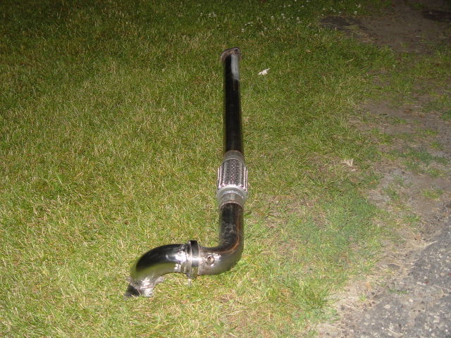

pict 5

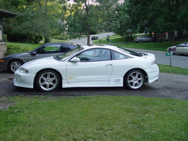

pict 6
File Type: jpg Exterior_Garage_Shot_Front_Hood_Closed.jpg (40.1 KB, 93 views)
