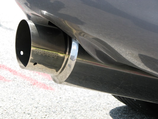

I had another opportunity to have some more work done to the car so the next thing I couldn't tackle myself was the exhaust. I worked with MAP again to plan for the future and decided to go 3".
Kyle fabbed up a great system putting in a 3" Megan Racing Down Pipe, 3" Magnaflow High Flow Cat, and 3" Custom Cat-Back to a 3" inlet - 4" Outlet Megan Racing Muffler.
I am starting to get used to the exhaust and it has a great Deep tone to it but around town it is a bit on the Ricey side due to volume and drone but definitely worth the pay off. It did throw a CEL for about the next 100 miles then after a ECU reset is now fine.
