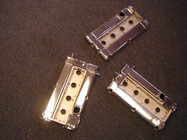

I actually offer a Shaved Valve cover service. I do it on my Dad CNC machine.
pics attached.
