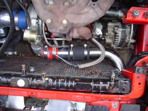

can you re-index the compresser cover and run the IC pipe closer to thge radiator? and run a 90 into the Intercooler. Kinda like this

Carltalon - If I turn the compressor cover so it's against the radiator like that, won't it damage the radiator over time? How did you get fans to fit with it done like that too?
