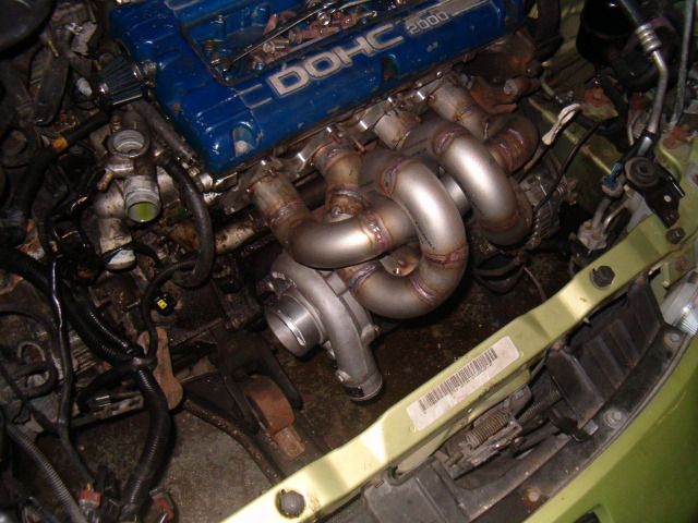

This one is a more standard fitmenr for your average car that can still retain power steering and run a MAS w/ any extensive wiring, etc. Full SS contsruction. Wastegate placement will come up the middle between runners 2 and 3 in that open space.

You guys like them long-ass runners, huh?

You should lower the runners for #2 & #3 or say bye-bye to your carbon fiber hood or your paint on the factory hood, especially on a 2.4L.
How's that for ya??

These are just mock up's anyways. As far as 2G's go, trying to get anything to fit those is a lost cause, there's so much less room than a 1G
