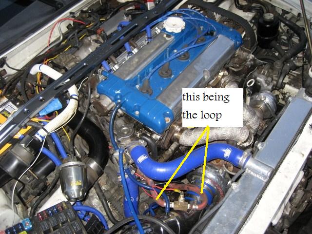

i have the turbo water lines in a short loop I.E Jason the guy i bought it from so coolent ratio should be 50/50 I'm down to headgasket or maybe just not enough flow to the radiator

so i just looked at the pic that i posted which was a from when the previous owner was selling it he switched it to the stock not even an inch radiator and i just noticed i think i might just need a new radiator also how can i get my car to idea less rough since i removed the emissions crap
