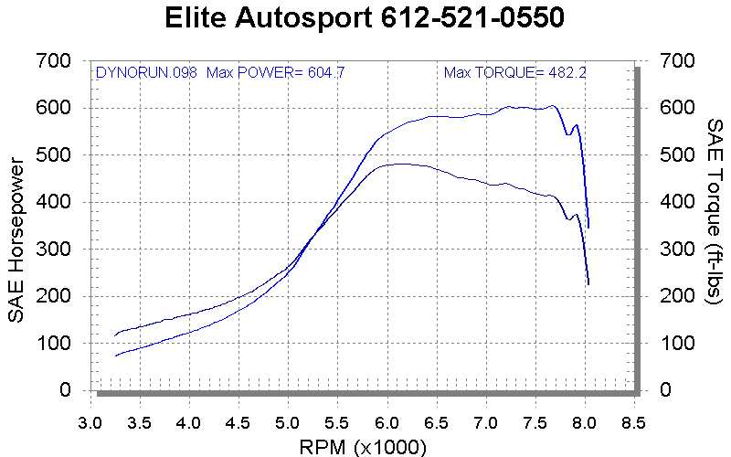

Dynoed my Honduh Accord yesterday....
Built shortblock, stock head, stock cams/IM/TB. Using some Turbonetics T3/T4 Hybrid JDM turbo off a Drag gen 9 kit or some shit yo.
That accord ;)

Nice, but that's a laggy bitch. What engine and internals are you using?

Hopefully once that bitch gets spooled you can keep it that way. Nice numbers though.

Nice #'s. It is amazing that a honda 2.2 builds less torque than a mitsu 2.0 though. What boost was that at?

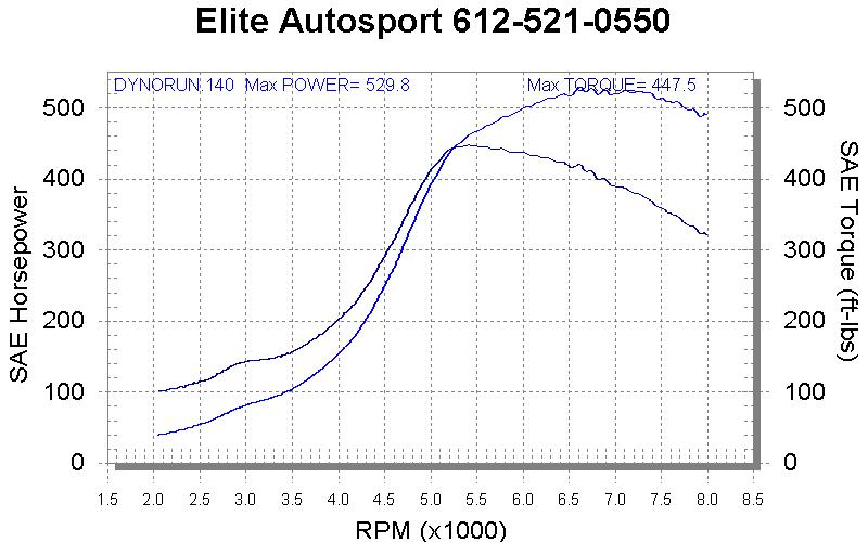

Sorry Jet but you are mistaken. Here's a dyno of John L.'s 2.0 with the same turbo and same boost. Stupid V-tAk

He was "only" making 530 whp though, get a graph of a DSM making 604whp once and see what the torque is.

Where are some 600whp 2.0l dyno graphs? Lag makes less torque, if it spooled earlier, it would make more torque. It would be hard to spool that turbo on a 2.0l DSM any quicker though, without a bunch of nitrous, since it has 1.5ls more displacement. When he does cams, intake manifold, etc the torque will probably stay the same, but the HP will go up up up and look more like a VTEC car. The top end power is getting choked bad by all the small stock shit on it.
Old 05-17-2005   #11
Re: Dynoed my Honduh Accord yesterday....
Yeah, I can tell he was hitting a wall. That is a 3.5l ?? Seems like a ton of lag for a 3.5l.

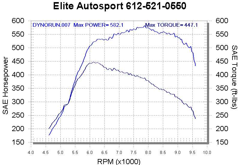

This is a 2.0L DSM making almost the same amount of power. It lacks torque.
