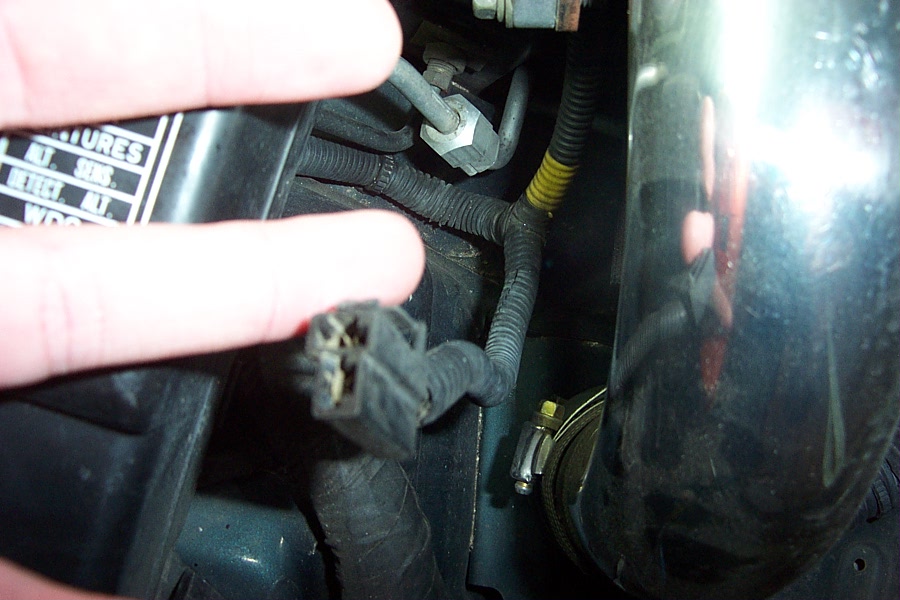

Hello all.
I was looking over some of the Intercooler piping for loose clamps and such and came across this connector hanging in the wind.
Any help identifying whether it is needed would be greatly appreciated. The other bundle (yellow band) that is with this connector goes to the MAF plug.
The car is a 1994 Eagle Talon TSi.

Re: Need Help Identifying Connector
Stock boost control solenoid. Not needed if you have a boost controller.
It does have a manual boost controller.
Thanks for the speedy reply!!
