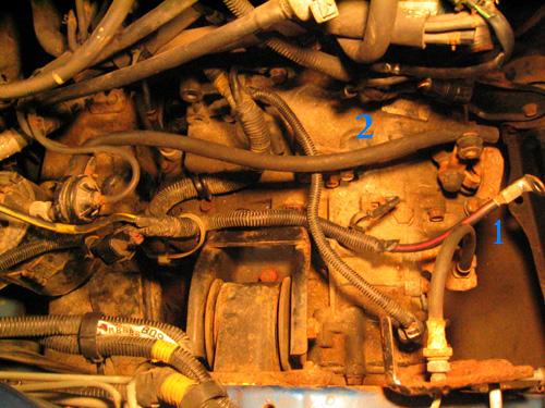

When Brandon (me612) helped me w/my clutch, I was removing everything on the bottom while he removed everthing topside. I have 1 wire I'm not sure where it goes and I believe that the hose is just a vent. take a looky.

1= starter
2= intake maf to turbo

One is just a ground that needs to be bolted to the block with a bolt that holds on the transmission.
Two is the charcoal canister vent and should be routed back into the intake pipe for emissions purposes(yeah right).

Cool. So the starter has two wires, should the second one be grounded to a starter bolt too? I already have the little one (all black) grounded like that.

1 should go to the batery if i remember right..

the starter should have two wires one small one clips on one big wire that is constant positve, being bolted to the car is ground.

1) power wire from starter TO battery.
2) vent tube from charcoal canaster TO the intake pipe. There should be another 'hose' that goes from the valve cover to the pipe as well.

Thanks guys, everything is now correctly in place.

hey sorry Austin. I just seen this today. Just like CVD said. The wire goes on the positive terminal, and the hose connects to your intake.

And no 10 people didn't say the same thing. Some said its a ground that is to be hooked up to the block or a starter bolt. One said it goes to the battery but didn't really specify which terminal. And so I'm saying it goes to the positive terminal on the battery. But for some reason I'm questioning myself. Not exactly sure if it goes on the positive or negetive. Wish I had my car here to just look at.

that is a power supply wire.

Red stripe = Power.
