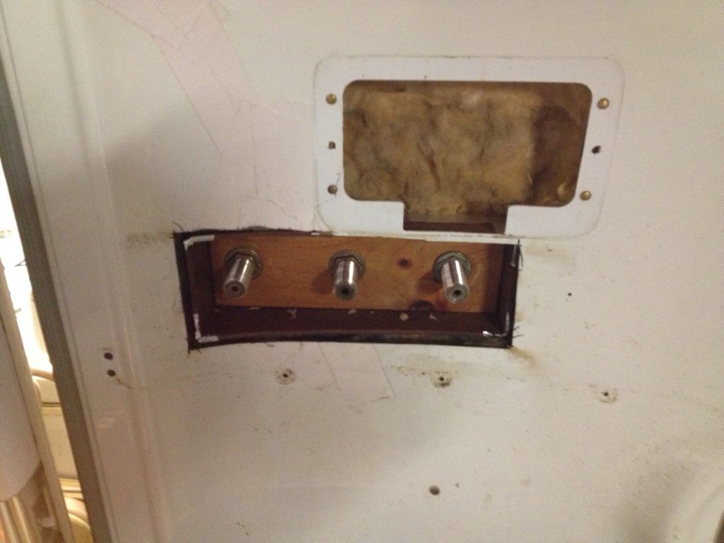

Going to have them out the door. Got the 7/8 shank holes drilled. Found out that the shanks I had where going to be to short to go all the way through. Would have needed to get 3 6" long shanks at 30.00 each.
So I ended up taking out the egg shelf and butter storage. They will go back in. I cut the back of the fridge door out so I could use the shanks I had.

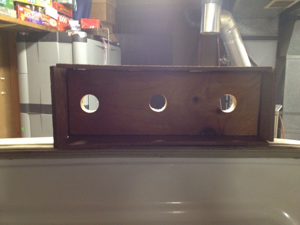

Made a filler panel for the hole and so I can get the jam nuts tight on the shanks
In its hole
Shanks installed. Just need to get one more tap.
Just need to get some white duck tape to Finnish it off and put the shelf and butter holder back in.

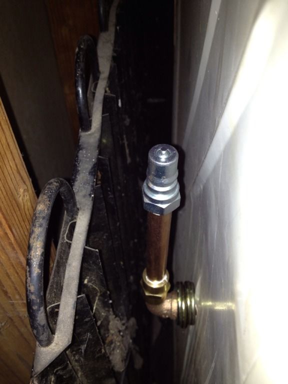

built and installed the c02 manifold today. both ends of the fittings are sealed on /off
installed

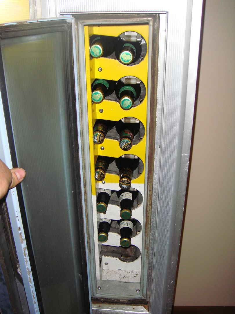

1960 Pepsi machine. Made s.s shelfs for it.

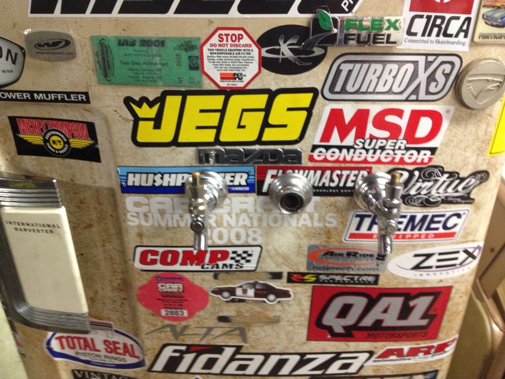

Found this on craigslist this summer for a killer deal.

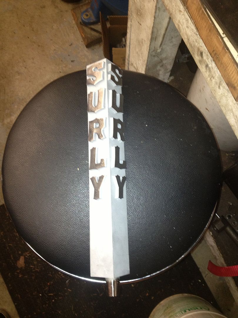

Then did some upgrading to it. Added a second tap, a C02 manifold, and some lines to run use homebrew kegs. I also added a couple homemade tap handles. One of them is a cam from Scheides old Evo 8. The other is a twins logo CNC'd into plastic as a test for the same thing in a baseball bat handle. I have a few other ideas in the works.
Also added a $25 fish tank temp controller. Wired it into an outlet to control the fridge temp.
Recently added a third C02 line so I can run one Sanke keg and 2 home brew kegs. I have another tap but haven't had a chance or need to put it on yet.
