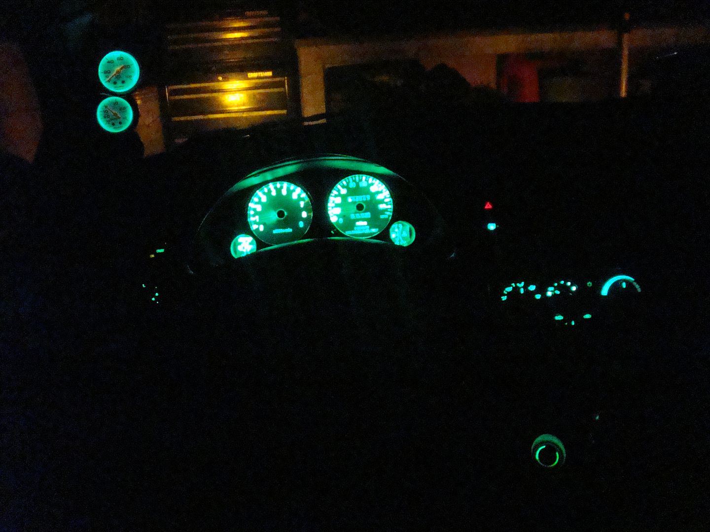

You have to take your cluster apart and sand off the orange coating on the back of the gauge faces. I did it to my '95 TSi AWD so I could change the color or just go with LEDs. I have yet to do anything with it, but you can tell a difference between what was orange coated before.
Old 09-30-2013   #5
Re: Gauge cluster color change 2g
That's what I did. Took it apart sanded the back of the gauge faces and put in green LEDs
