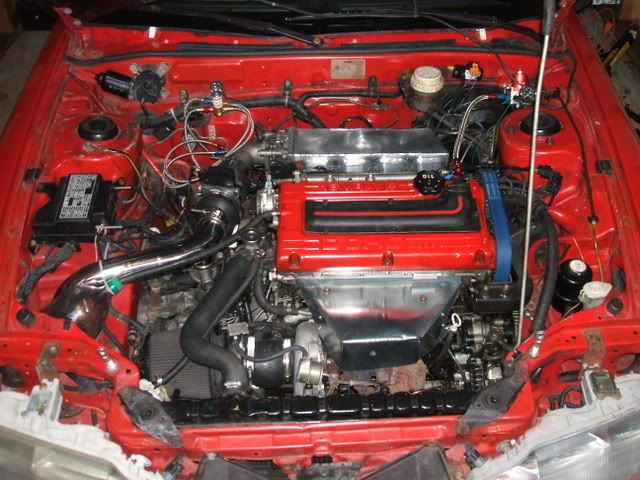

Going over all of my threads I realized that I didnt have a project thread dedicated to my 92. I have a few threads here and there showing whats going on with it, but nothing thats been updated and openeded.
I got my 92 back when I started college and had no clue what it was. I just knew I wanted something turbo. So I went to wisconsin to pick it up. She was all stock and an AUTO.
Just like every other DSM it started to get modded. I bought an ebay 16g and supporting mods and miraculously it lasted a whole year of being beaten on!
Then like all ebay turbos it started to fall apart. So i upgraded to a 50trim, and the mods to support that.
Then while I live in winona, we had some crazy floods and the national guard wouldnt let me into my dsm for 7 days. she sat in standing the whole time. But I didnt want to give up on the car. I pulled out the interior and installed new carpet, seats, headliner, panels, etc etc. and all the gaskets in the engine.
http://www.mitsustyle.com/forums/showthread.php?t=17134
Then I played around with nitrous for a little while. It was fun but i sold it for a better toy. I also switched over to e85 at this time.
Then after 2 auto trannies died on me, it was time to swap over to a manual, I really couldnt afford the 3000 for a good auto tranny.
http://www.mitsustyle.com/forums/showthread.php?t=24444
So far i havnt driven it on the new manual setup. It still has a few bugs to work out. One major problem is the used RPS pressure plate that came with the manual swap parts is UNGODLY stiff. ive never felt a dsm clutch nearly this stiff and ive felt many. so i might have to get a new clutch setup before i take it out.

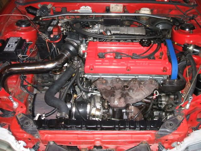

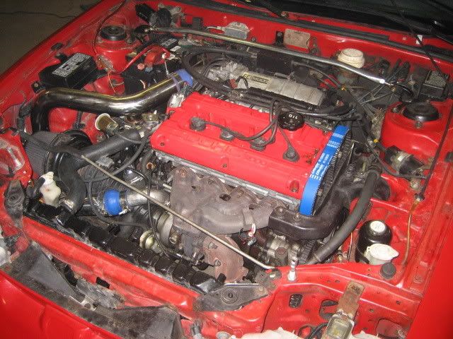

Stock bottom end
ported head
bc 272s
pte 1000cc injectors
aeromotive FPR
COP for now but going to an ignition amplifier as soon as i wire it in
QPR intake manifold
pte bb 50 trim
ssac fmic
dsmlink v2
maft
greddy timing and balance shaft belts
4 point roll bar
fidanza flywheel
twin 255s fuel pumps pushing e85
etc etc
