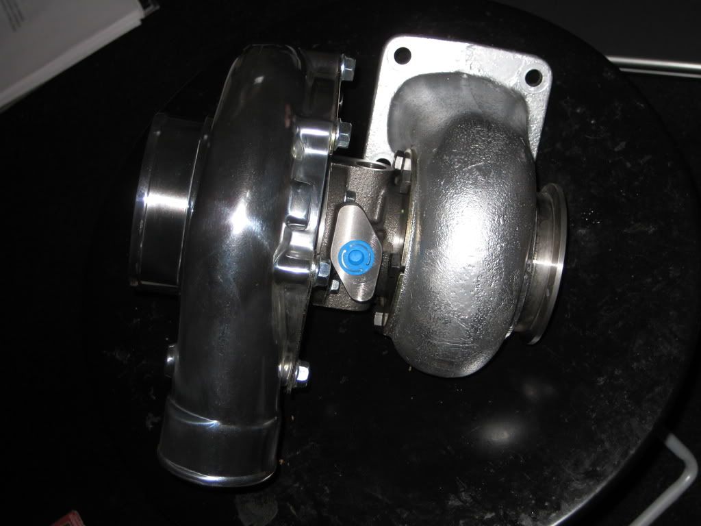

My turbo is ceramic coated. The outside is the only part that gets coated. Never coat the inside. Make sure the place you go does a good quality ceramic coat to get the full benefits of holding in all that heat to help spool up.
Here's a pic.
http://i307.photobucket.com/albums/n...o/IMG_0085.jpg
