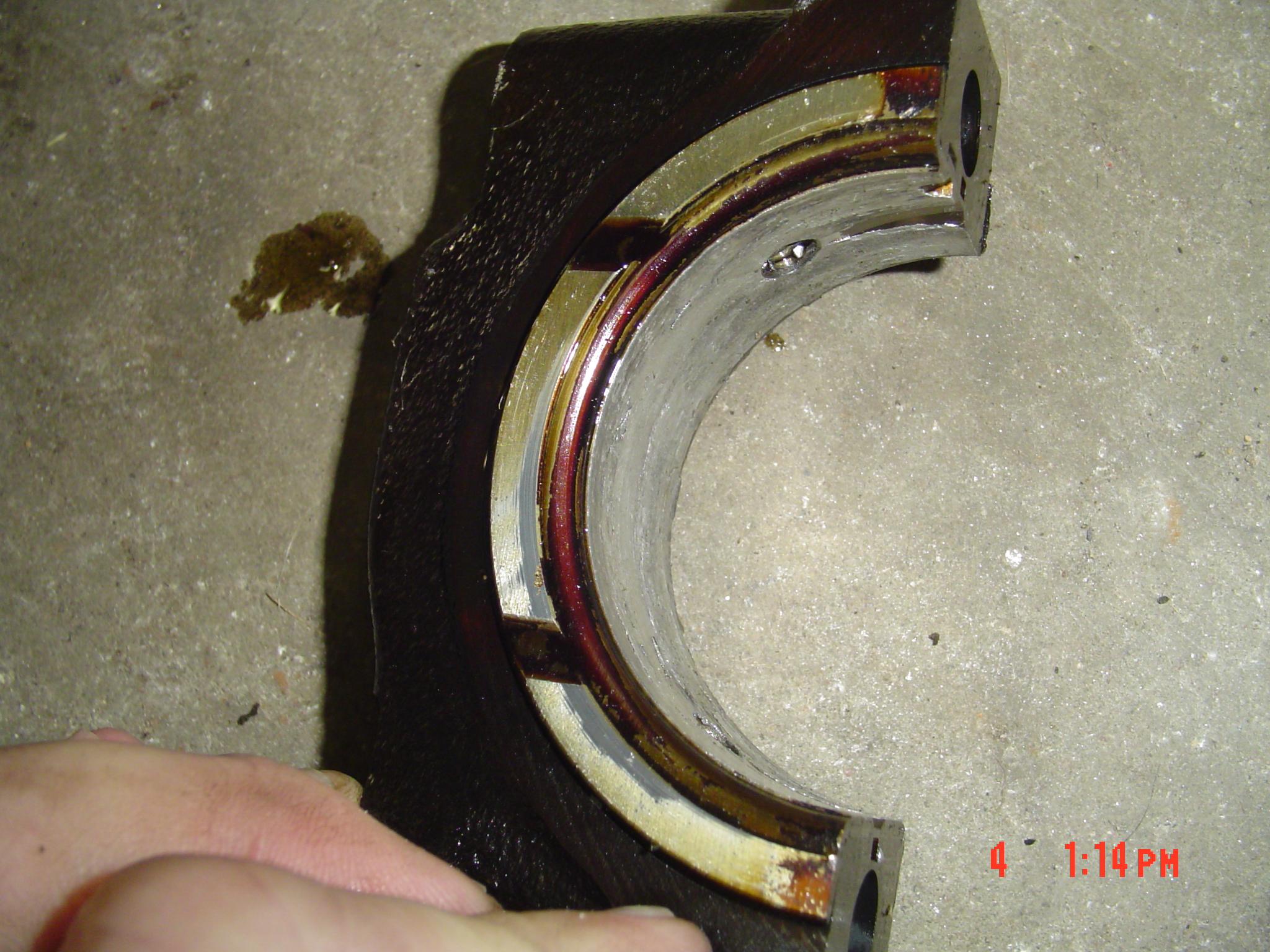

well 6 bolt motor guys should take note... you are not immune to crank walk. I didn't bother to measure the walk in this but its at least .020"
ID:	7801   Click image for larger version
