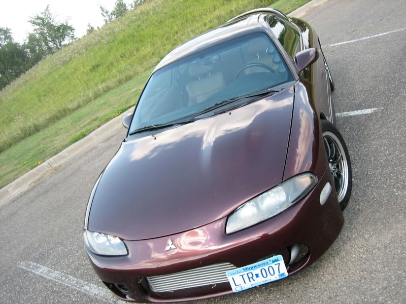

When I bought the car. One of the very few times this car has and ever will see snow. Some things wrone with the car when I got it: poor front buper fitting, needed new lugnuts, much doghair needed removing, ran lean, super bent rim.
Gotta love the poorly fit front bumper and lack of intercooler haha

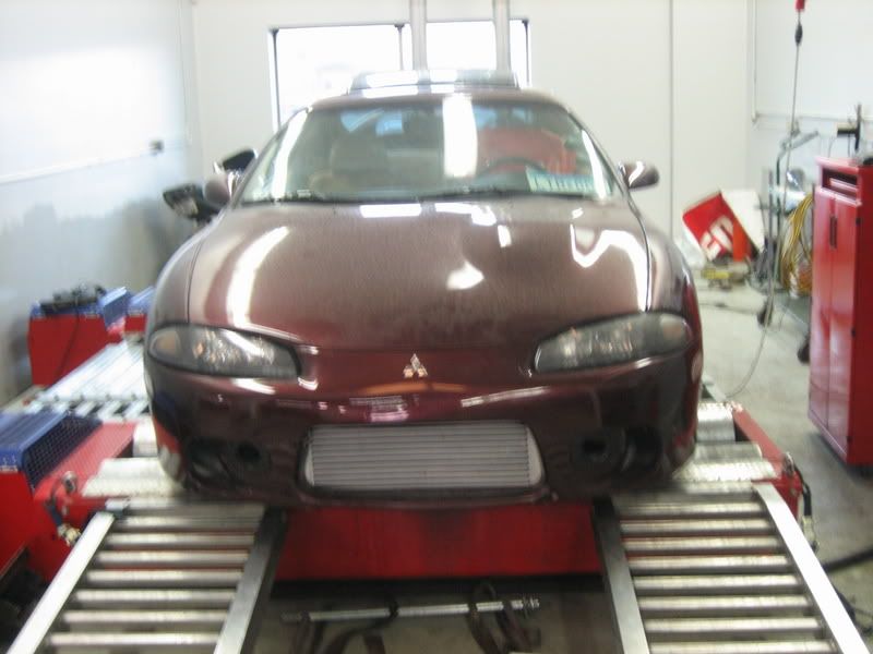

One of the first things was the dyno. It made 210awhp but was running ean so I stepped it down for the time being.

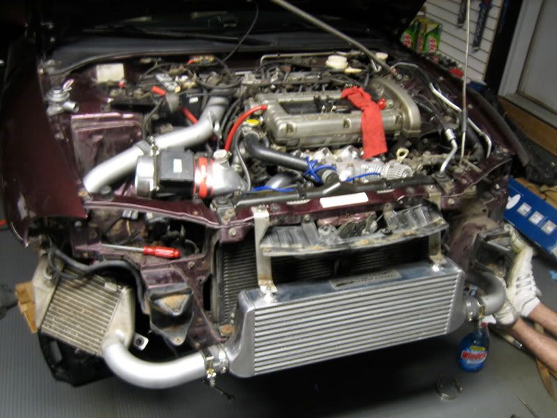

I then got my hks external wg to fix my major boost creep issue. I also got a new p/p big16g and had a blast with my first turbo swap. Took e and waldro like a week because we kept needing new bolts and stuff and when you can only work at night it makes things hard. Finally I learned if I wanted to up the boost of my 16g I'd need a fmic. Well this was a task and a half. No that smic didn't stay on too long. I soon had some custom piping done. Notice josh's legs haha. he got tired. This was done the night before I left for school.

Back to the dyno she goes to get tuned. About $1000 later I climbed to a sad 265awhp sadly.

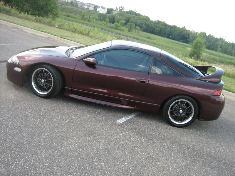

For now though this is how she sits.
