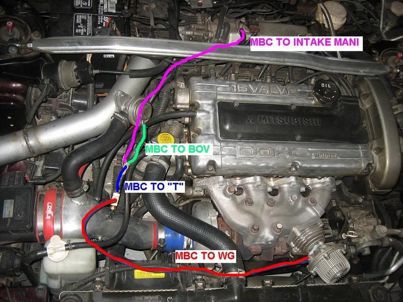

Old 05-30-2007   #6
Re: MBC lines
Here is what mine looks like. I believe the benefits are less boost spike, maybe some other things too that I can't remember.
Then for the BOV just run a line straight to the intake mani.

Old 05-30-2007   #7
15min late to the world
Re: MBC lines
Clean your mbc out, running off the compressor housing will allow the lowest boost possible. Most people run the line off the intake manifold like you have it now.

Old 05-30-2007   #8
Re: MBC lines
I used to run one pressure source for both the BOV and wastgate but was having some issues with my MBC also holding boost. I ran them independently and that fixed the problems.

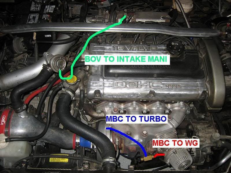

Old 05-30-2007   #10
HiImBrian
HiImBrian's Avatar
Location: FargO
Drives: the girls crazy
Posts: 3,012
Re: MBC lines
Fixed it! I ran the bov to the intake mani and the mbc to the wg and to the turbo. Thanks slowboy! I actually had more than enough line the way it was so I just switched em and now she bangs nicely.

Old 05-30-2007   #13
Re: MBC lines
EDIT: I am dumb.

Old 05-30-2007   #20
HiImBrian
HiImBrian's Avatar
Location: FargO
Posts: 3,012
Re: MBC lines
This is where my lines are ran now. Idk if that will help or not but I thought I'd post it up.
