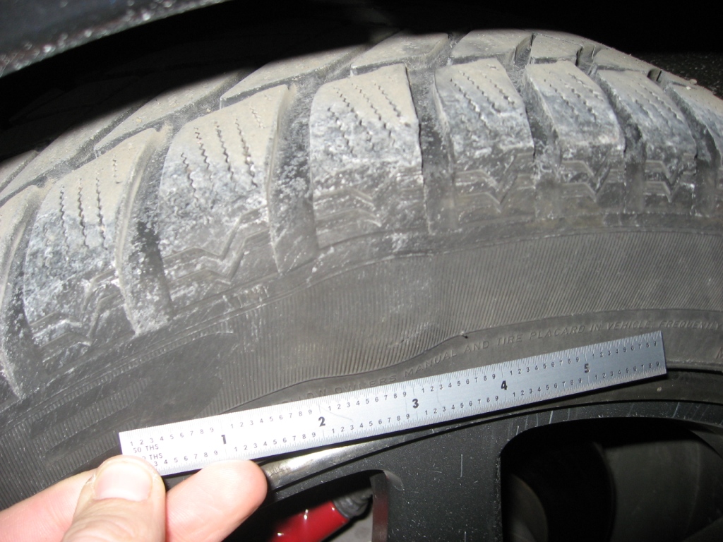

Was just down in the garage and I noticed that my passenger side rear tire has a bulge in it. How bad is this? Do I need to go find another tire....
thanks

Where did you purchase the tires from? That bulge should qualify as a manufacturers defect, so you should be able to get a pro-rated amount toward a new replacement tire.

My buddy had a lump way bigger than that on his tire on his van for a while and he had to end up getting it replaced. Not until he beat the shit outa it for a while. Probably not a great idea, but you should be able to drive on it for a while if you need. Better to get it replaced sooner than later.

Yeah, I would get it replaced pretty soon. You broke a cord inside the tire. Don't get too crazy with corners or high speed until you get it replaced.
Most likely due to hitting a hard bump in the road. I've seen it happen many times. If you ignore it you risk the chance of the tire blowing out while driving.

That sucks. What kind of tires are they and how many miles are on them? Getting warranty coverage at a shop w/o an invoice is going to be pretty tough.

that tire is shot and unsafe to drive on. get it replaced asap.
