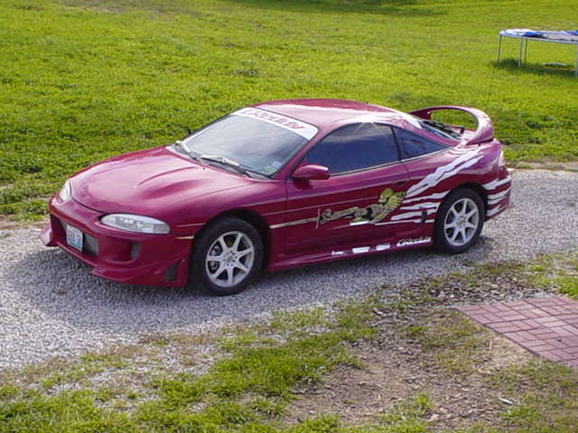

i have a 95 gst, bov, manual boost controller, no cat, intake, i dont know how much boost im runnin lol i cant find any one around this place to hook it and my air fuel up heres a pic, u might have seen me around the kc area

2 - Dude you have a sword sticking through your tires.
just givin ya shit, it's all good.
