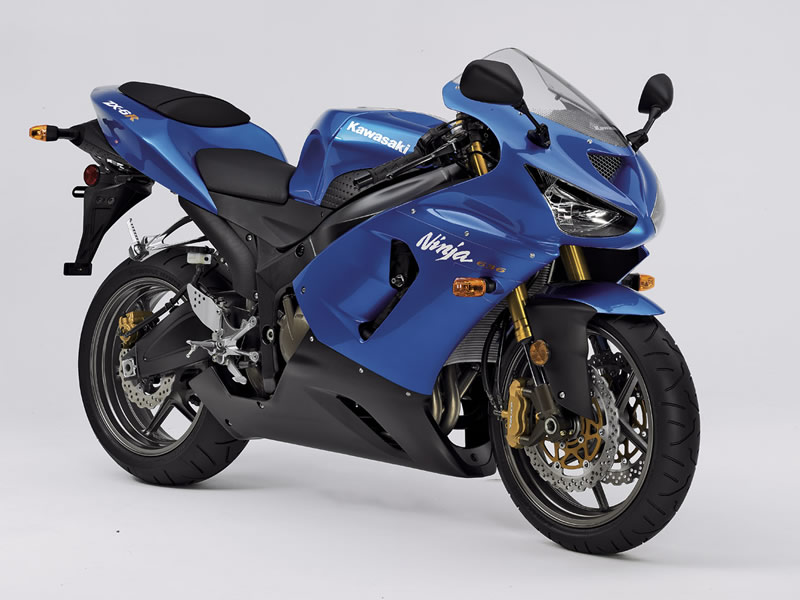

Well here's the solution to my gas mileage.

Emcee, we will have to go riding sometime! Do you have your bike yet? My buddy has a 03 ZX6RR. It is a really nice bike. I am sure you will be happy with it.
