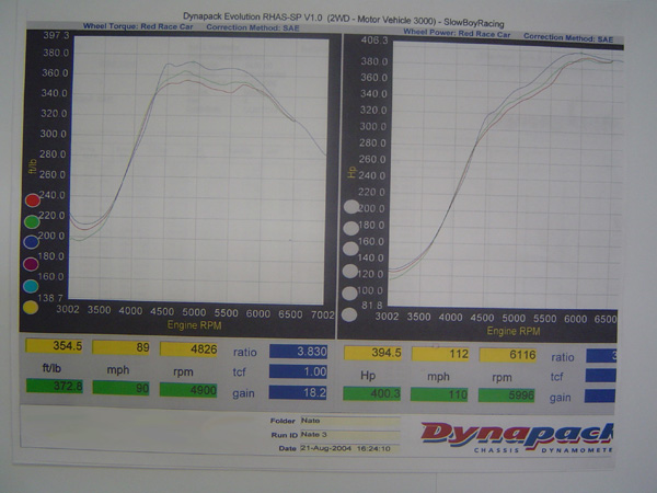

Posts: 2,206
Originally posted by CUSTOMDSM@Sep 24 2004, 04:24 PM
The turbo will make 400 hp with supporting mods.
CRAIG
Please link me to a dyno sheet with a 400 hp 16g please. I would like to see where it spools, hp and torque. Are you talking about on the juice?

EVOIII16G DYNO CHART
There it is for all you non believers.

Chart.

Wow, that is one laggy 16G.

Must be the .010" bigger wheel....

That is not a 16G... It should spool at around 3 grand max.

You should contact slowboy racing and call bullshit then. Seems laggy but they advertise it like that, so I wonder whats the deal?

Eh thats too much work...
Just seems way to laggy to me.

Couldn't it be possible the extra lag is from a combination of clipping and heavy porting? Maybe? :bounce:

A 50 trim isn't that laggy.
