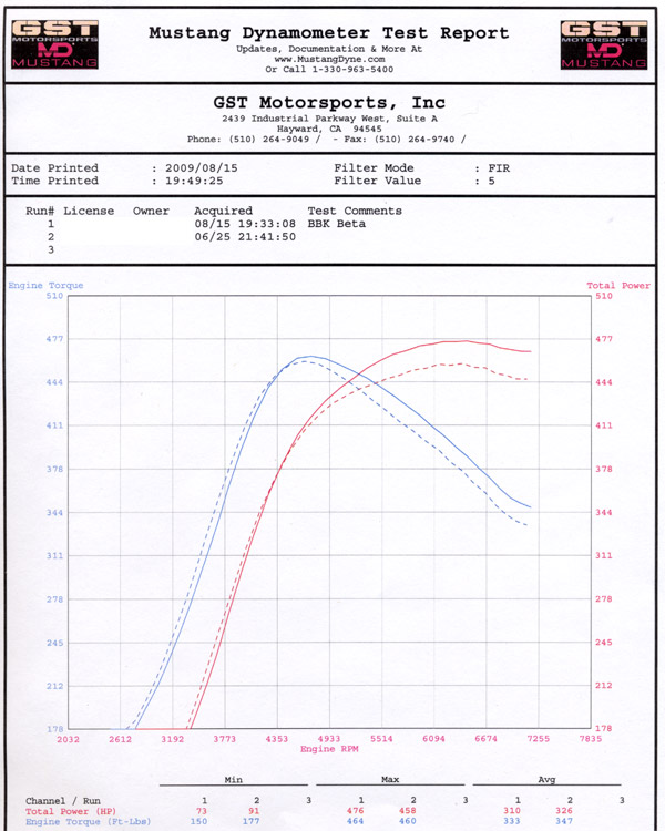

Then, the BBK was swapped out for the BBK-B Beta:
476whp/464wtq. Note the minor loss in spool-up and the basically +20wtq from 5000rpm up. Very little lost for a fair amount gained!
