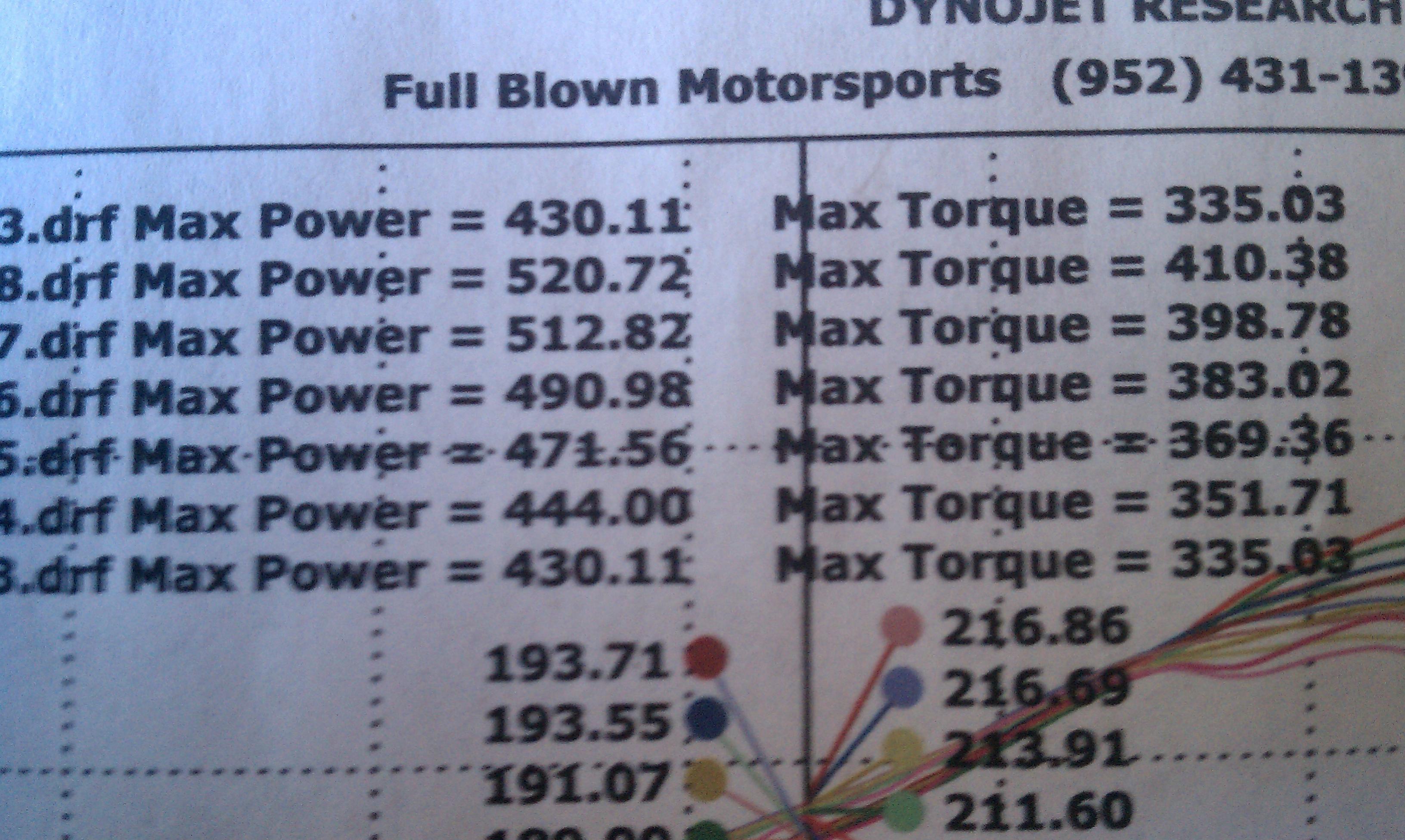

Since Ross hasnt posted his time slip I am just gonna go ahead and let everyone know he made 520hp/410ftlbs at Full Blown on 29 PSI.

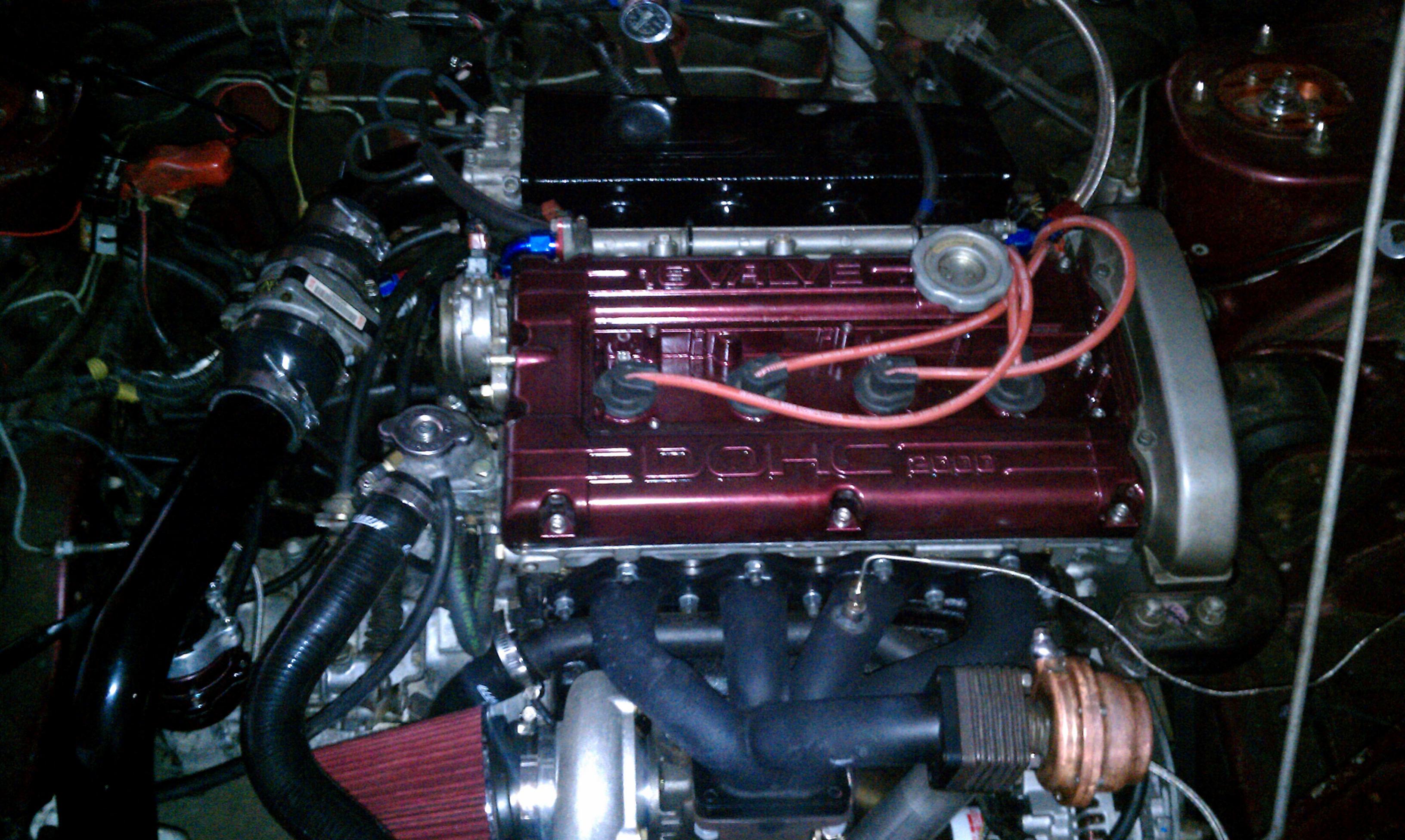

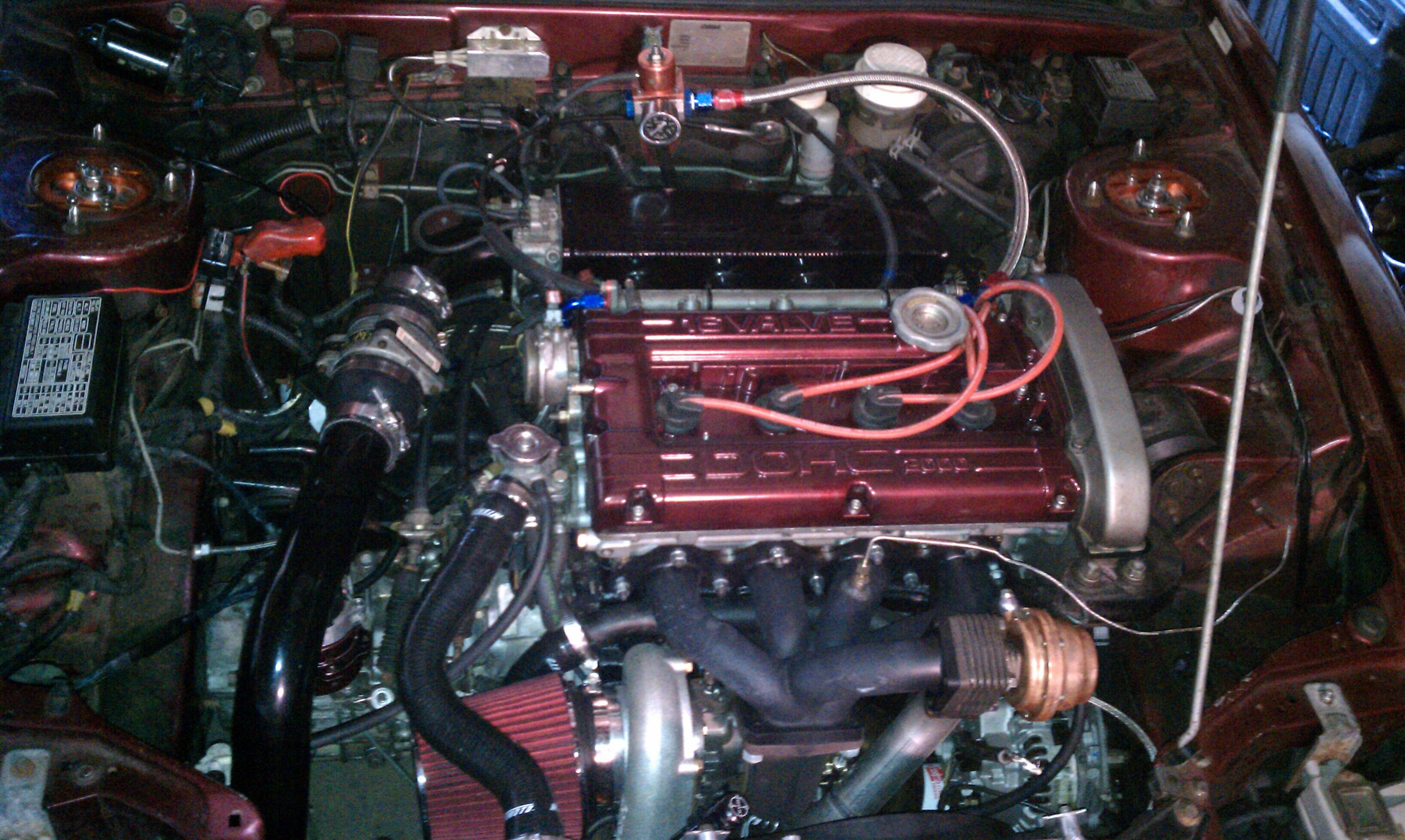

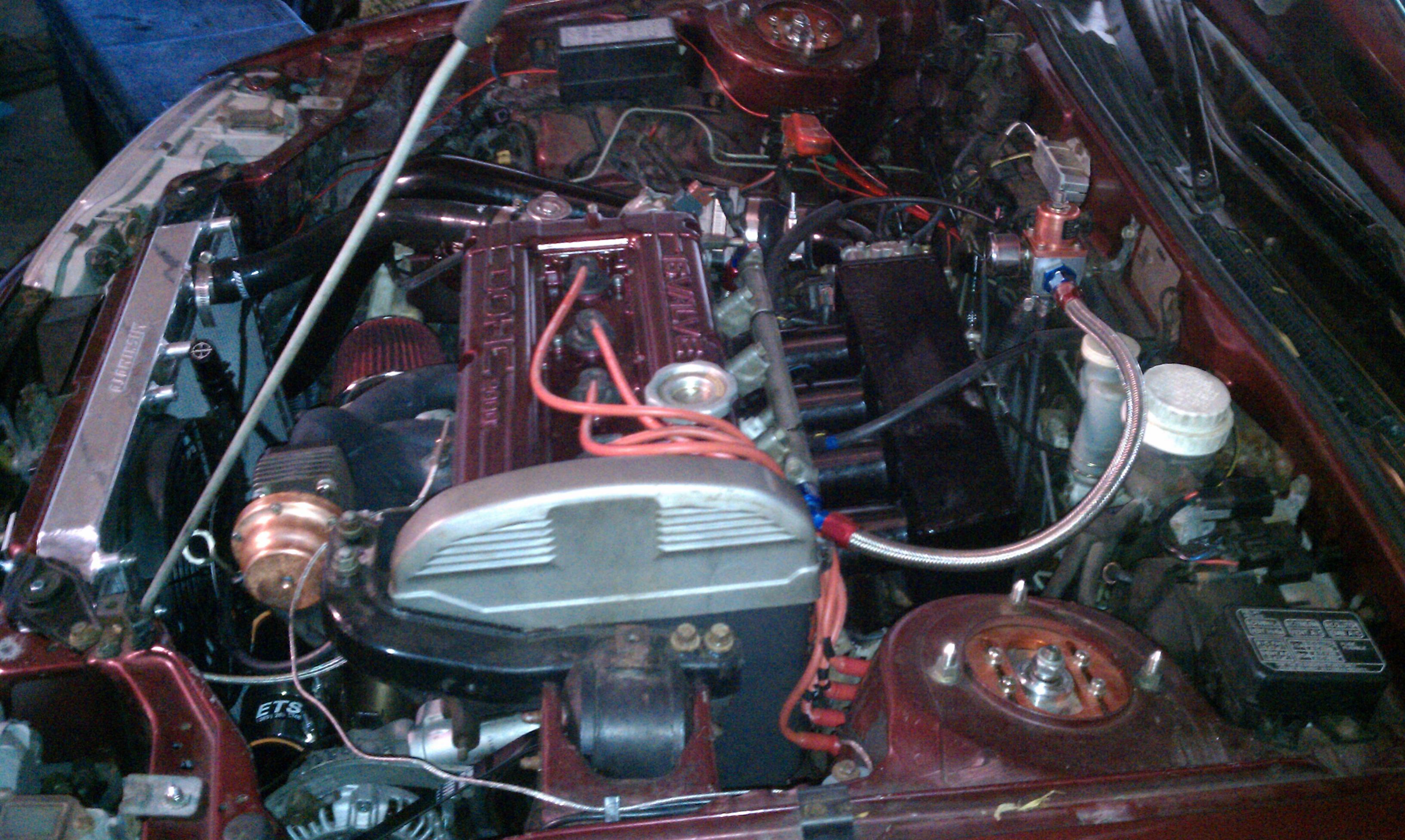

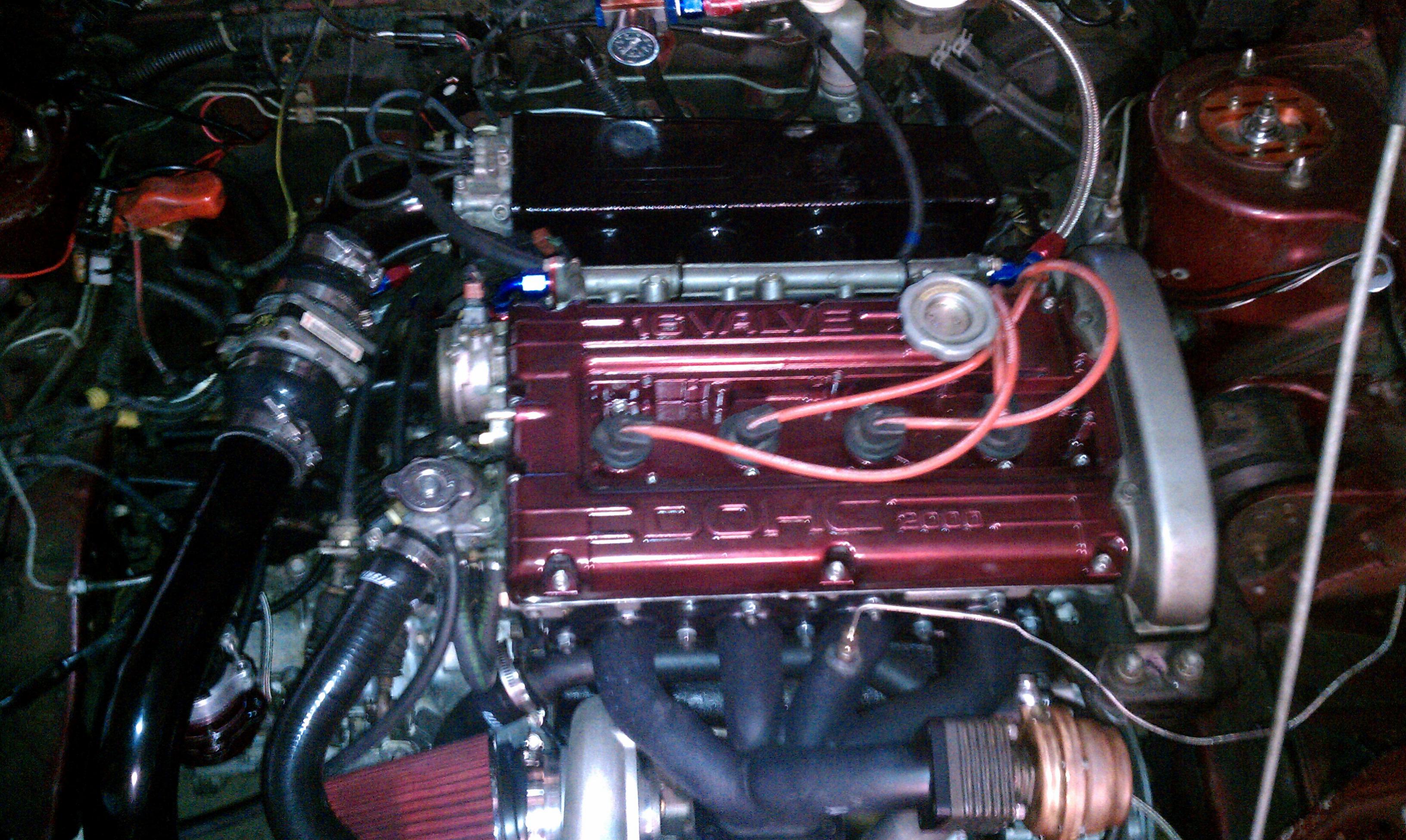

Ok so here is the list of mods
2.0 motor
Eagle Rods
Ross pistons
Remanufactured crank
ACL bearings
ARP Rod studs
L19 Head studs
272 Kelford cams
Stage 5 SBR head port
Ferrea Valves
Manley S&R
JMFAB Intake manifold
ERL exhaust manifold
40m Tial WG(15psi spring)
50m Tial BOV
Full Blown Dual walbro setup
E85
PTE6262(V-band, .82 A/R)
3in megan exhaust
K-Sport coilovers
ETS Race Intercooler
External Oil cooler
FIC 1600cc
Battery relocated to trunk
Prosport gauges(Boost, EGT, Oil Temp, Oil Pressure, Volt)
AEM Wideband
Hks Type 1 turbo timer
Mishimoto Radiator
Hallman Boost controller
3in GM Maf
Dsmlink V3 with GM Maf cable
Stage 3 Shep Tranny
Fidanza Flywheel
Act 2900

I read the post from MNSC, I would love to hear more about his 6262 setup.
Why did he stop at 29psi?

yeah a 6262 @29psi only doing 520hp seems pretty low on power. At 29psi you should have no problem hitting over 600whp.
I'm assuming full blown has a dynojet? At least that's what I recall

I think it was a highly conservative tune. It was its first time on the dyno and he didnt want anything blowing up. Haha he is having ALOT of fun with it though.

Im nit saying Ross socked at all anywhere, everyone should remember..just because the turbo is capable of x power, doesn't mean the rest of the setup will allow the turbo to do so. There could be a weak spot or something that explains the "lower" numbers. That being said, congrats to him and a fun car. It still makes more then 90% of this and most boards.

I don't understand why 520 at 29 psi is low for a 6262. Please explain further? Maybe a compressor map.

520 is ok, but Fullblown has an AWD Dynojet, so it's like making 445awhp on my dyno, which is good but nothing crazy for a 6262.

Hi I'm Ross. I love the car and hopefully i can make some more power out of the car soon. LJ at FB did a great job with the tune the car was a S.O.B. to just get tuned.They have a AWD DynoJet. Just wondering why these numbers are low?
