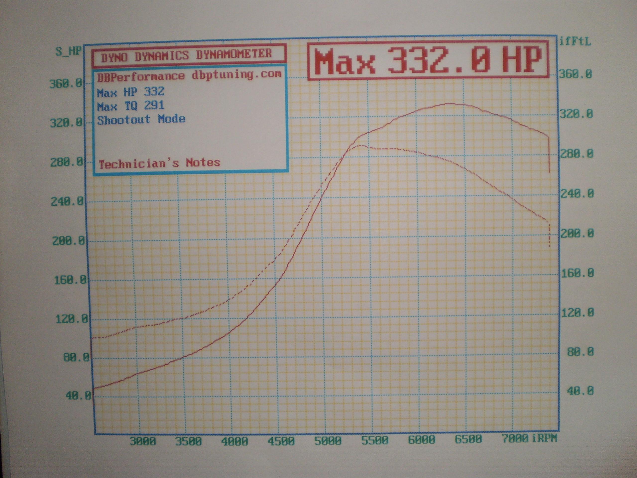

well I got the talon tuned yesterday
well I brought my car up to db and had shane tune it yesterday and here are the results. not too bad I guess

I like the results, congrats!

Awesome, how about a mod list so we know what we're looking at?

here's a mod list for yall
bullseye power t04b vtrim (yeah I know it sucks but i got for 200 brand new)
fp cast race manifold
3in turbo back exhaust
ported o2 housing
big fmic with 2.5in piping
gm 3in maf
walbro 255 fuel pump
aeromotive fpr
fic 950cc injectors
ported and polished cylinder head
bc 272 cams
dsmlink v.3
and I'm sure there are a few things i'm forgetting and this was on pump gas

So what did it make when it wasn't in shootout mode?
I'm guessing about 275 HP 240 TQ?

thats a hell of a guess it was 281 hp and 246 tq
but I'll think i'll stick with the 332 hp

oh yeah thats a 25 psi spike settling to about 21psi

thats pump? thats damn good.

yes sir that is just good ol 92 pump gas

Since when did shane ever print out graphs in shootout mode?

idk but thats the one he gave me

I have been giving out both normal and Shootout mode numbers for only a few weeks. It pretty much gives outs numbers between SAE corrected and STD corrected numbers from a Dynojet AWD.

Das coo, at least its mentioned specifically on the sheet to keep things straight!
Still great power for pump gas!
