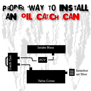

Heres how we 420a's roll. Whether this helps or not or is completely stating the obvious. Anyway

Originally Posted by 95talonracer View Post
Anyone have photos of their setup as I am looking to properly hook up a setup like this. Can you Y the 2 off the valve cover into 1 into a catch can and have one vacuum line running from the intake sucking from both of these all the time or is that too much?
From the Krank Vent thread...
http://dsmstyle.com/forums/attachmen...5&d=1206053635
