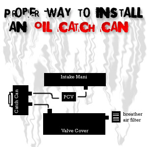

Anyone have photos of their setup as I am looking to properly hook up a setup like this. Can you Y the 2 off the valve cover into 1 into a catch can and have one vacuum line running from the intake sucking from both of these all the time or is that too much?
BLaCk_1cE 04-11-2008 12:33 AM
Re: catch cans?
1 Attachment(s)
Heres how we 420a's roll. Whether this helps or not or is completely stating the obvious. Anyway
Attachment 7214
