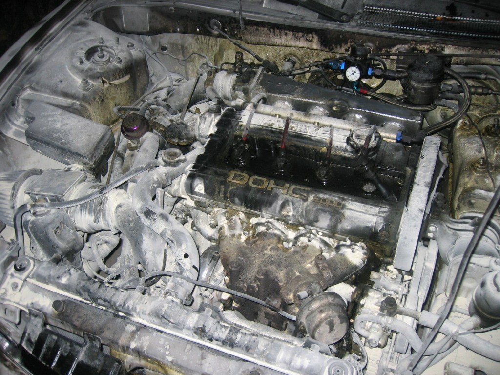

Well, i was stupid.
I put my 50 trim back on so i could go to MOD (mitsubishi Owners Day) and i made a huge mistake with the oil feed line, I had one barbed nipple on the turbo side, and a barbed on the feed line. So i took a small peice of fuel line and clamped each side.
Well Tonight i went out to our local meet and my buddy with the true silvia showed up. We got a couple races set up and decided to go to the spot and do a couple runs. On the way to the spot me and the silvia decide to make a run. After the run i see a ton of smoke coming inside the car and out the back of the car. I was thinking it was the head gasket so i slowly pull over to the side of the road. My roomate who was in the car with me yells "GET OUT! your cars on fire"
I jump out and see the fire in the engine bay and out the bottom of the car. Im running around frantically trying to put it out but none of us had a fire exstinguisher. the cops were on their way. The cop tells me to open the hood and sprays the fire out. I got it towed to the house...
and here is the aftermath....

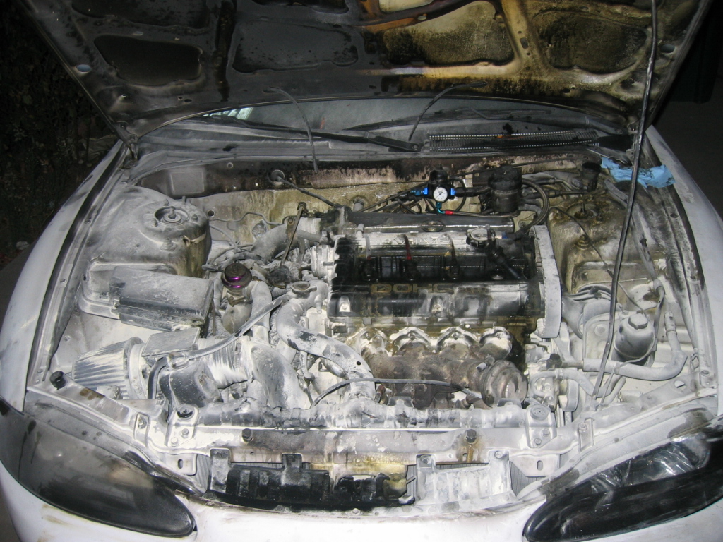

Looks salvageable? Lots of soot everywhere, but did you melt the wiring harness or anything?

Power wash the engine bay and see what looks alright. Looks just like a lot of soot.

Looking at the damage some more, it does look like mostly the fire exstingwisher (sp). The fire was mostly contained in the front right by the turbo, the two fans are completly melted, a couple hoses are melted, and the coolent resivoir was melted and the hoods paint melted. but other then that most of it just wipes off. Ill take a couple cans of degreaser and a power washer to it maybe tonight and see if there is any more damage.

that FPR still looks good

The BOV does too...hahaha
No no its not funny. Sorry to hear that. Atleast the fire did not get to a fuel line. But like you said does not look that bad. Good luck with it Tom hope a few things need to be replaced.

The reason those two things look untouched, is because i wiped them off. The guage on the fpr looked liek it was really charred as well as the bov, but after wiping them off they looked brand new. same with the headlights.

So was it your oil return rigging that caused the fire I'm assuming? Or what was it?
Sorry to hear though man, what a bummer.
yeah the oil line popped off under the pressure, and must have sprayed oil on the exhaust manifold and open wastegate. and all over the fans.
