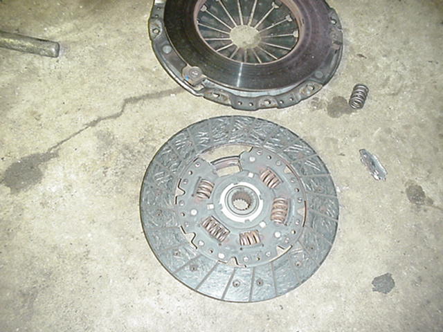

well today after getting some more wire for the welder to do the heater air intake for the evo swap. the 2600 went out on the talon. I knew the t.b. was going out it was strating to make some noise but what I found when I got the tranny out insted of working on the mirage was this. also the back side tranny bolt broke in side of the tranny so I have to drill it out and retap it also

I have seen so many discs do that. You would think they would make a little better design.

Sucks man, sorry to hear that. This is one of the reasons I advise against ACT products.

this is the first on that has done this and it has been in the car for 3 years now

You must have an older disc. I heard they fixed this problem with a revised disc design. I guess it's the price you pay, my clutch is going to PTT today.

My disk had 3 springs and 3 rubber pieces, the rubber peices had been completly shredded. It was bad. So i replaced the disk with a stocker, its working fine now, i still have the ACT Pressure Plate on

I used an 2600 for 10K+ and it wore away my pedal assembly and it also wouldnt engage because the fingers would not fully release. Replaced it for a southbend that held harder, and was more comfortable on my leg.
ACT have had nothing but problems, and if you look around on some of the dsm forums, you'll find the exact problem that happened in the first post.

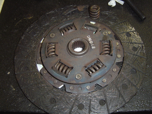

Here is a new Napa disc that I had on my Talon awhile back. It sucks I walked up to Napa and was like look can I get a new disc. They gave me one. Eh...shit breaks...my next clutch be from ACT thats for sure....
