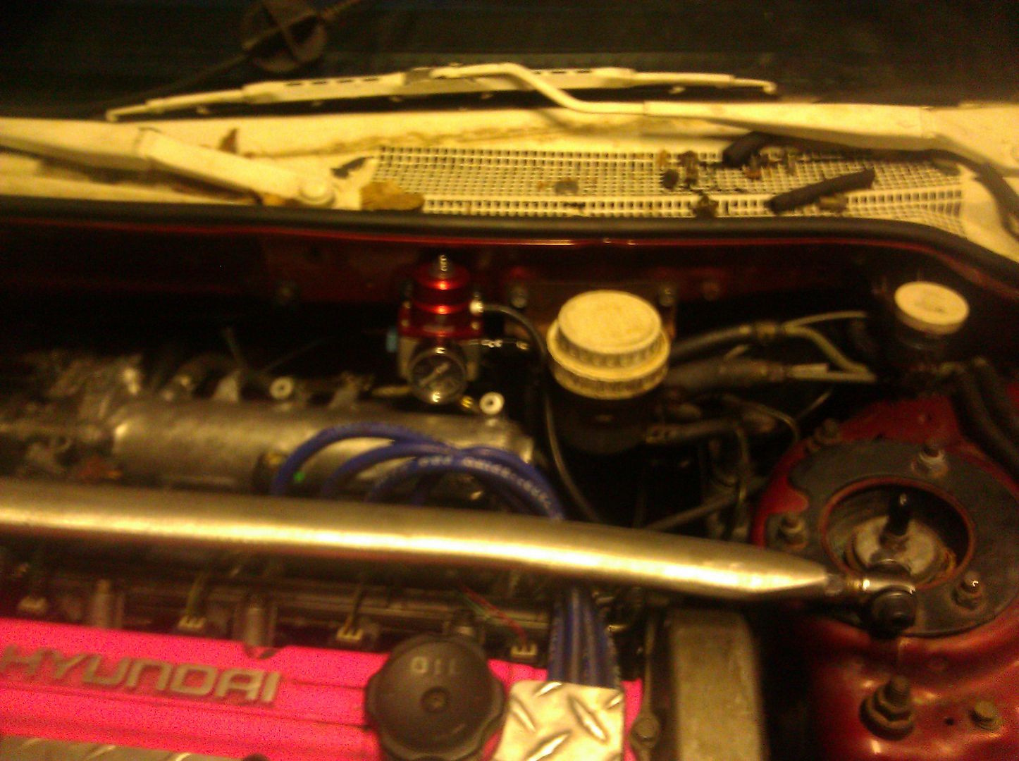

got the afpr put on the car. mounted it were there was 2 holes that are factory so that is were it went for now. I might more it some time but did not want to drill holes in the the car. Also put in the wally 255 that is modded.

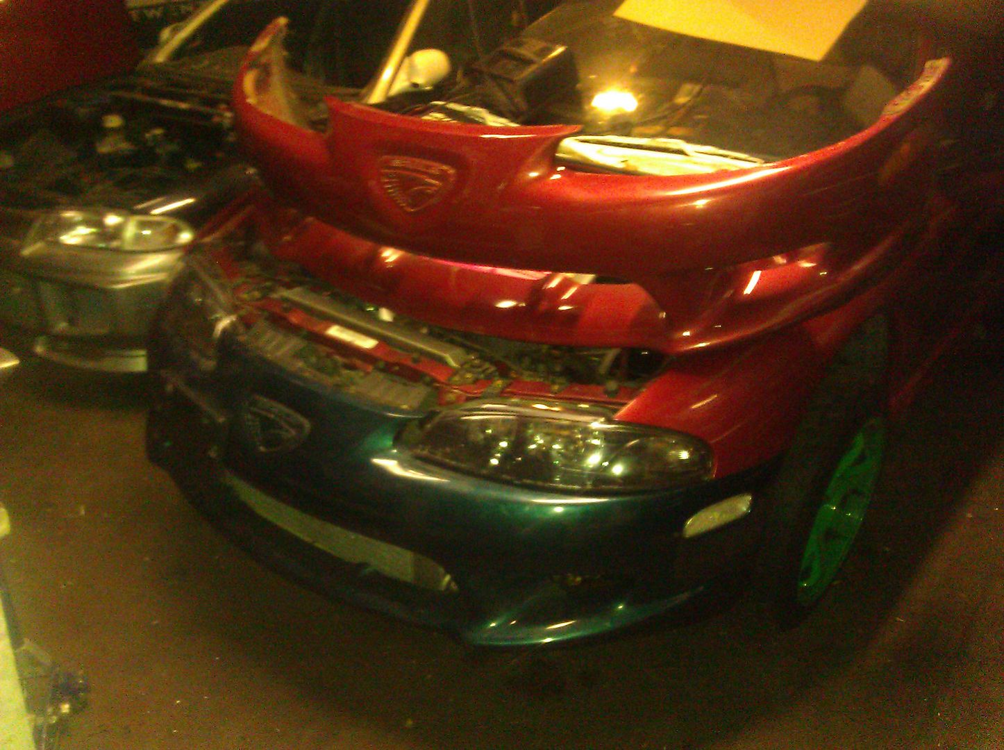

Got the color matched 2gb talon bumper put on. Got it trimmed just to make it fit. look 1000 times better than the green one since it match's the car.

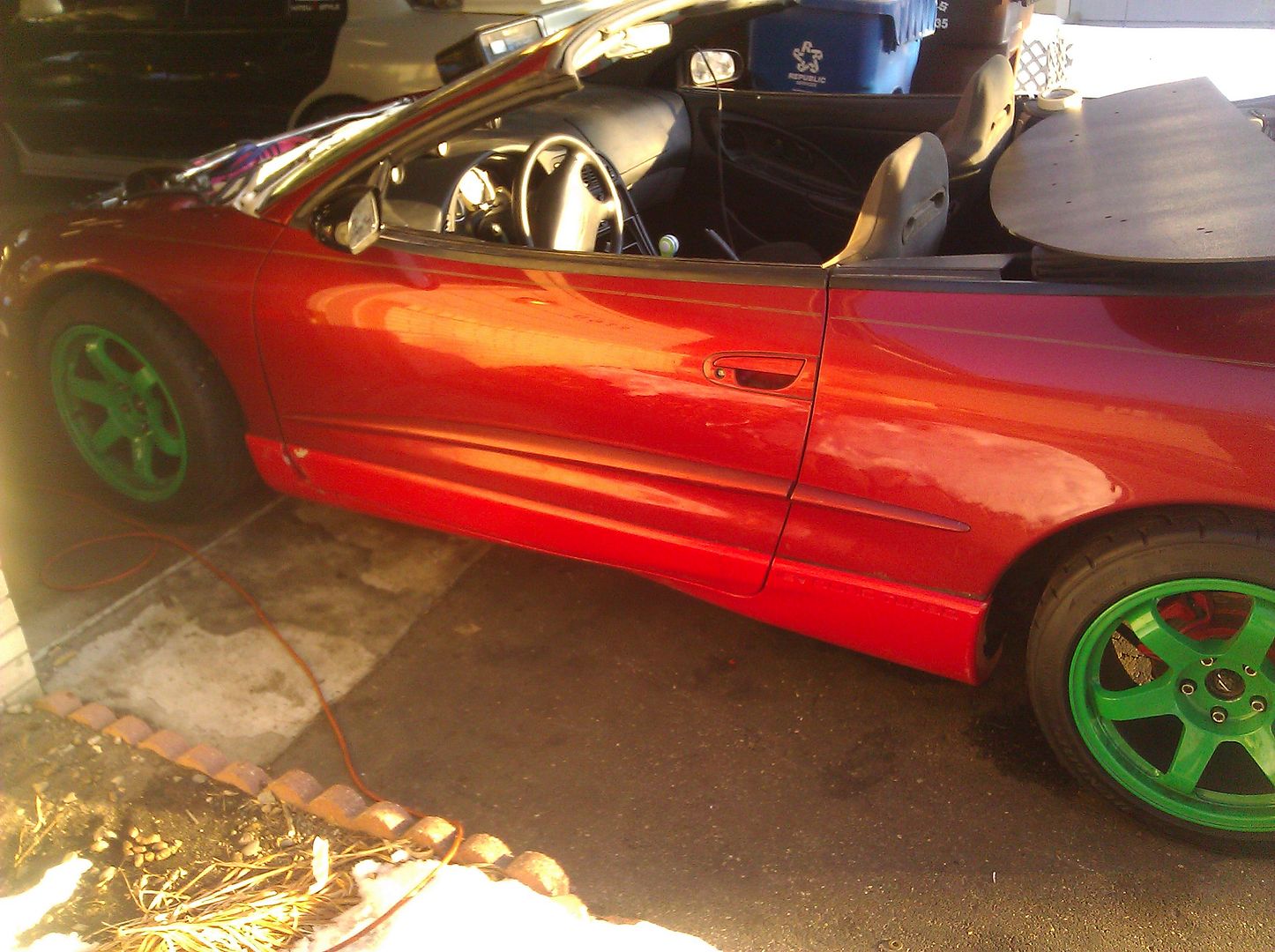

I raised the car up today also. 1/4in in the front and 1/2in in the back. So no I should have plenty of room for the new rims. The rear Qt. panels now have 1.75in from tire to Qt. panel. Before I could just get a finger between them.

had craig get me a new miata battery since the one was junk.
Today I scored 2gb talon door strip's and a talon 2gb rear bumper both of them are cayenne red pearl so the car will be all one color but the 2ga talon twisty skirts that are red. Just have to wait to for them the show up.

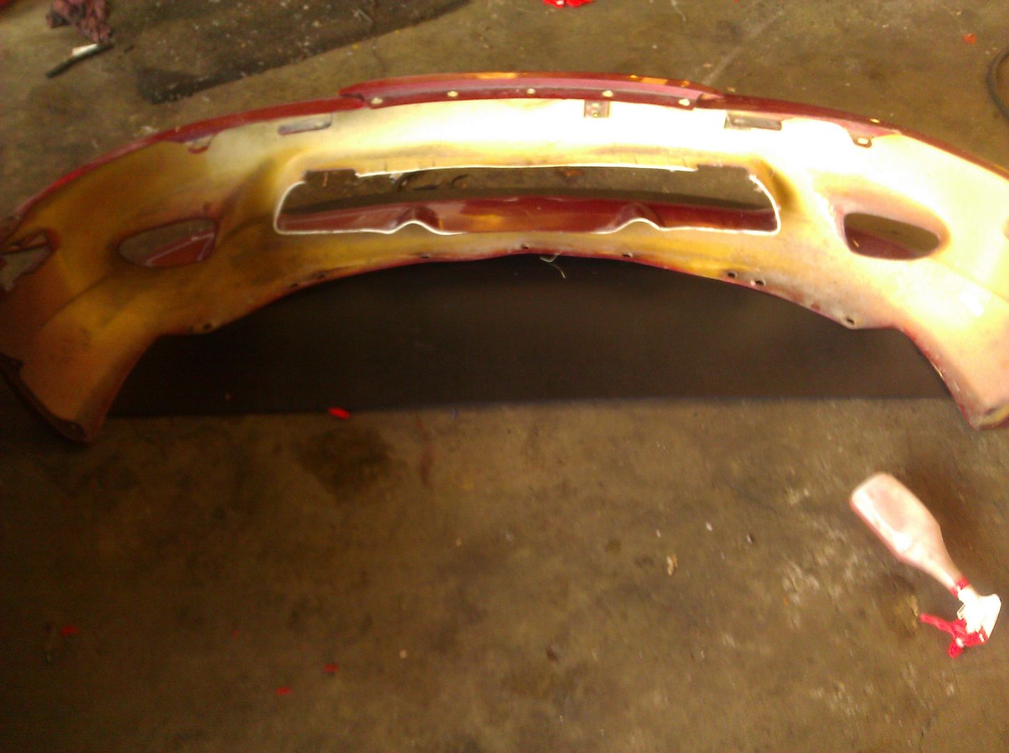

Yes I have the center cut out of a junked 2gb eclipse bumper the I will be cutting up and using to fill the gaps in the talon bumper to the 2gb head lights. I am doing it since I have never liked the 2ga head lights at all. It will have the gaps till I do the body work and paint it.

I am a body tech so it is no big deal for me to mod the bumper. I dont like the design of the 2ga head lights that is why I am going to mod the bumper it self

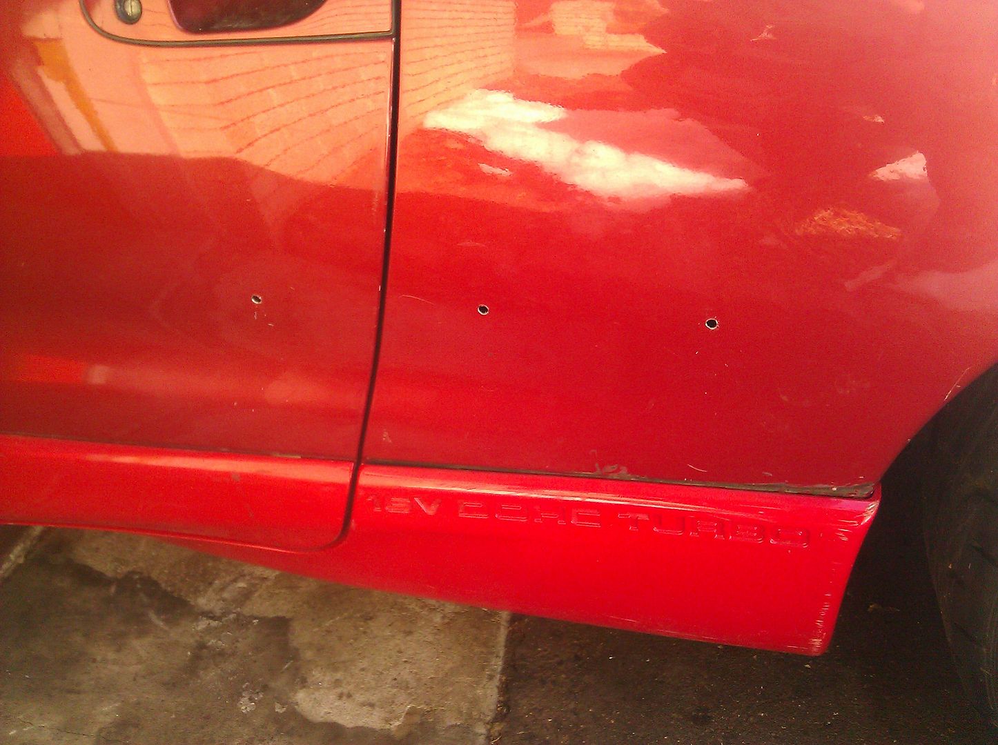

Got the strips on the car. Big thanks to tonyseagle for making a template for me.
got the holes marked,drilled, and painted the bare metal.
Installed

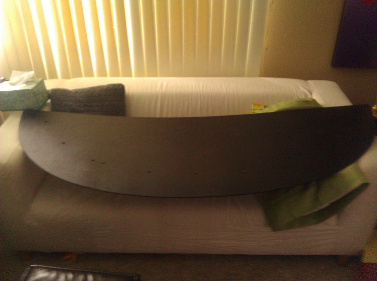

now the not so happy. I did not even think about it the front diffuser is for a eclipse 2gb bumper and not a talon 2gb bumper. So the holes are in the wrong spots. With it lined up with the holes it does not stick out the 2in that it should. I moved it out the 2in so it is right and I like the way it looks.
and the problem
3.5in to short to the back of the bumper
So it looks like I will be selling it now
