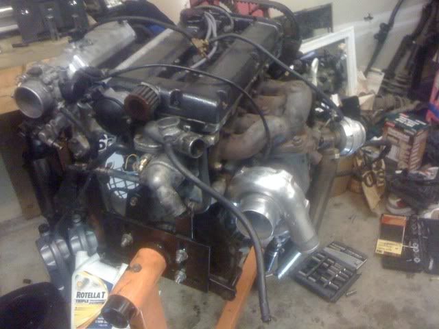

Little update.
I ended up breaking my crank by the # 4 rod bearings.
List of things that will be done to get it back up and running.
Oem 2.4 crank from Leasure
oem timing belt
power solution ml headgasket
L19s
acl race bearings
clean and inspect everything
I'll update with pics as soon as it's out

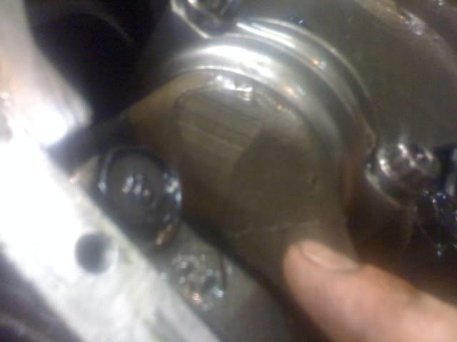

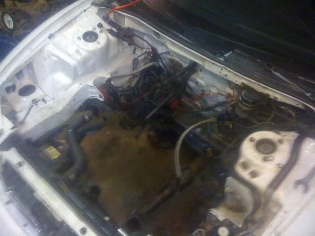

Crack! its hard to see but there
Its prolly been awhile. LOL
Now to put the front suspention back together and roller her on out the garage.
