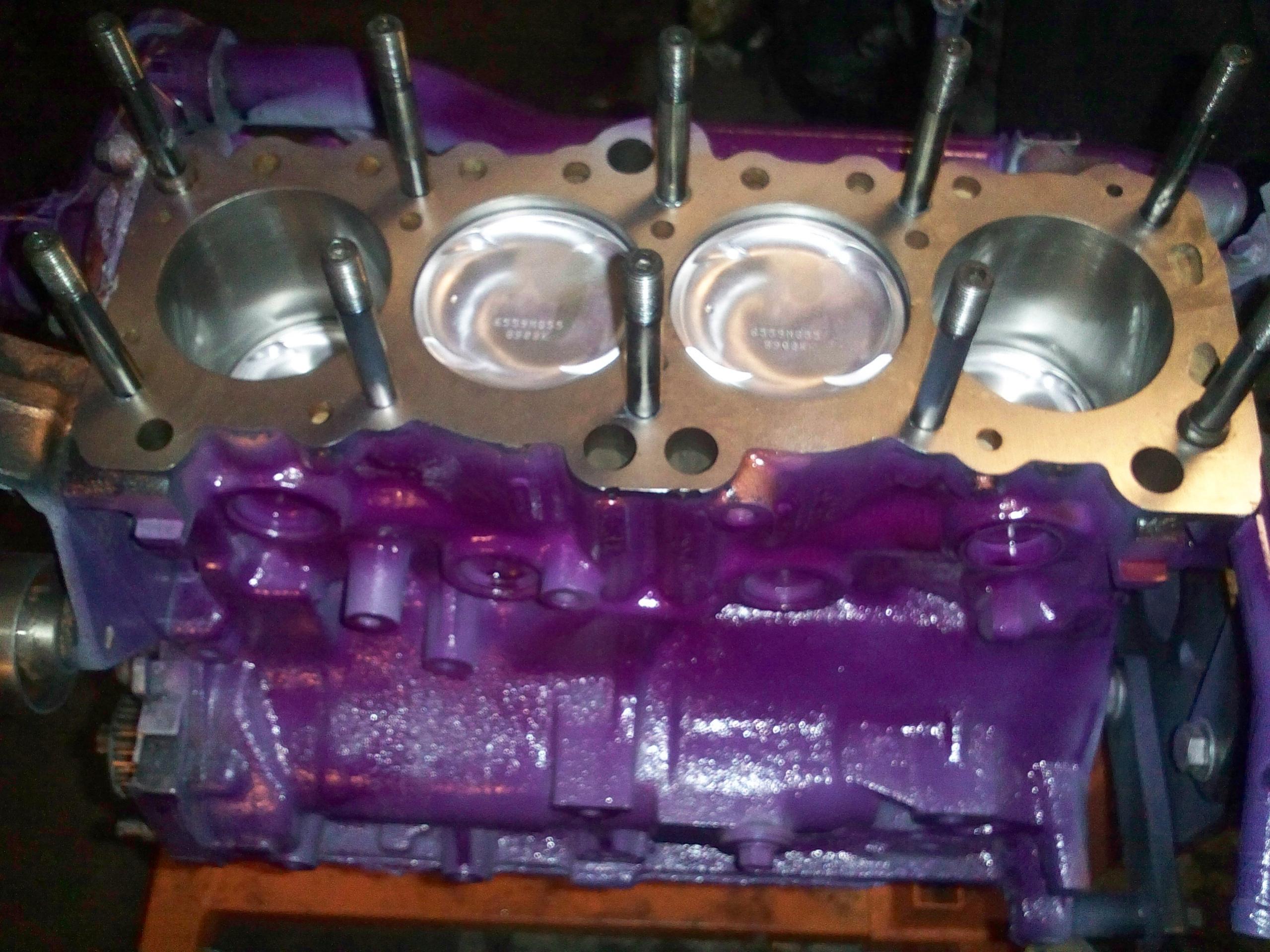

point is they are standard my purchase order says .020 over
picture is when i first got it all together what it looked like
