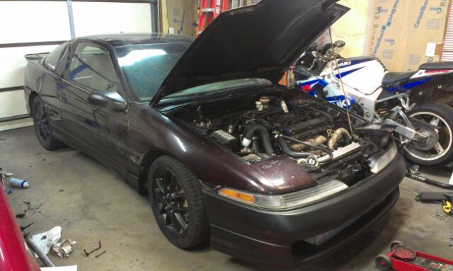

I haven't updated this thread in a long while, basically in a nut shell i never quite figured out my parasitic draw. However the conclusion me and another friend came to, was that ABS module relay was drawing power, as well as my heater circuit ( the abnormal behaviour was that the blower motor could be turned on with the key off and out the ignition. )
Next... , but not least is the window circuit also drawing amperage, with the key out. To fix the abs module issue we just unplugged it. As far as the window and blower circuit im not quite sure yet havent traced the wiring yet.
In the mean time I decided to give Plasti dip a chance. There are a few picture of what exactly i Dipped. I went as far as trying my valve cover, Wheels, Front Bumper, Side skirts, Hood, Interior ect. If i get the chance to order the spray gun, i might try the roof or the black portion of the two tone as well....The valve cover probably not again....(Seemed like a good idea at the point, until i remembered temperature after everything was installed) However believe it or not the Plasti Dip held up fine to the temperature however it was contact with fluids that it could not stand. Specifically hot oil
For the more exciting news, I finally got the chance to make the switch to Corn. Which was exciting but sort of stress full. Getting the car all up to par ...getting metering devices hooked up. DSM LINK kept showing to codes Engine temp sensor as well as knock sensor circuit. Those issues eventually got sortted out. As time went along I also got around to ordering my FIC 1450CC Injectors. 280BC Camms, which are not installed yet. I settled for about 26-28PSI of boost and Turned it down from 30PSI which was the max boost i ran with no difficulties. Besides blowing my intercooler piping apart for now.... (I am in need of a bigger boost gauge as well)
Link
I also did a few random things between here and there. Enjoyed the car on E after it sat for the whole winter due to a transmission issue. (2weeks if ...that!) The problem causing me to park the car was one of the c clip's to keep the shift linkage in place. In the Engine Bay (Which i was positive i checked, oh well it was fixed)
Catch can mock set up
Super filthy car but bumper is dipped and side skirts done
Turbo size differenze ehhh not to big but i like it for its streeteability
Just some random picture of the Talon last fall downtown ...all cleaned up...dents to fix so many dents to FIX! Winter was harsh!
Unfortunately the vehicle is again in parts and pieces as of last week... in the drive way snowed in :/ Background story on that, i was having issues with one of my bell housing bolts continuously coming loose. Or i thought it was ‘’one’’ atleast... To keep a long story short and bring everyone up to date it snapped of the day before, i painted my interior and exterior ...INSIDE THE BLOCK ...!...Awesome! However i did not know this before hand and after fixing a few minor issues Boost leaks..exhaust leaks..oil leaks...coolant leaks ...Wideband reading funny and not matching the numbers in Link.
Yeah it was 50 degrees like two days before...which is why i event decided to do this outside...
I attempted going on a slight shake down run to make sure everything that had gone wrong was fixed. Fill up on fresh E85 to see whether, that might be the issue why i couldnt get the car to idle it was on Empty...as well as Degrease and pressure wash the underside of my Car. Fuel wasnt the issue HA! Stinking Transmission thats rattling all over the place was!
While pulling out the drive way the car just wouldn’t stay running, it was shuttering like no other i made it half way down the drive way and it was vibrating and shuttering so bad it Shut of …at that point I figured something must be loose ...went to go check the bolt that always came loose...and sure enough it was ….tried putting the New bolt I got for it in. Only threaded a few turns. And I realized a greater issue was at hand, and quit for the day. Bought new Drill bits ..extractors…lock tight and everything else needed to fix it once and right…Problem is after getting the transmission out I spotted a slight crack on one of the Bolt holes on the bell housing…great…At that point I figured it’s a loss cause…
Took my transmission over to John’s house who was nice enough to help me crack it open and also take a look inside at the gears… something I had been wanting to do for quite some time…and that was followed by some more bad news…No Major damage …besides some odd things here and there, instead just a 21 year old Transmission. Still shifted alright besides the second gear grind at high rpms...
Basically it was just worn out. So that’s where I am at right now just trying to figure out a quick and cost effective way to get it back up on the road and save up for a sweet shifting transmission. A lot of stuff happened in between.
-Like the story off my oil filter blowing its seal out
- The shake down run followed by the clinking noise that disappeared (Turned out it was the bolt that snapped off and fell onto the road)
-The phantom Boost problem....
-How i came up with the side exit waste gate dump pipe and some fabrication steps
Step 1 FLIP YO WASTE GATE UPSIDE DOWN !
-Step 2
Re-install your waste gate and be sure not to drop your fire ring else you wont be making any boost at all!
-Step 3
Find some all Jank Exhaust Piping like of your honda civics that you replaced with a nice ebay kit Cost still 0 Cents and 0 Dollars
-Step Whenever
Figure out where you want your pipe to come out
-Step 4
Mock up the pipe and get your bends figured out....if you cant bend ...well then cut and tack a million times cost still free 99
-Step 5
Figure the top part out and weld it all into place...tighten your bolts up make sure to figure out a way to secure the pipe...or use light piping ...remembering only two bolts are holding your waste gate pipe to your actual waste gate HA! I used an exhaust hanger...(the portion of the pipe that had the perfect bend and hanger location...so mine is sturdy. I would recommend perhaps even using a flex section oh and be sure to wrap it with heat wrap!
-ect ect Pictures speak a thousand words and ive already spoken a thousand or just about...If you see a picture just ask whats going on or ill try and add some description...while the day goes on.
My Goals and plans from here on out is focus on getting all leaks sealed up: Throttle body still has a slight boost leak, Re assemble my transmission, set up my suspension for some track time this year. My goal is:
- 10.9 in ΒΌ Mile With about 400-450 Whp and a see if we can get the car down to 2800LBS or so?
I think the car has enough power to perhaps do it. Yet i dont know anything about actual DRAG RACING LOL! But In reality I would be happy with a 12 second pass It’s a lofty goal but with a good shifting transmission and some driver modding it should be possible I hope…or think? What do you guys think?
