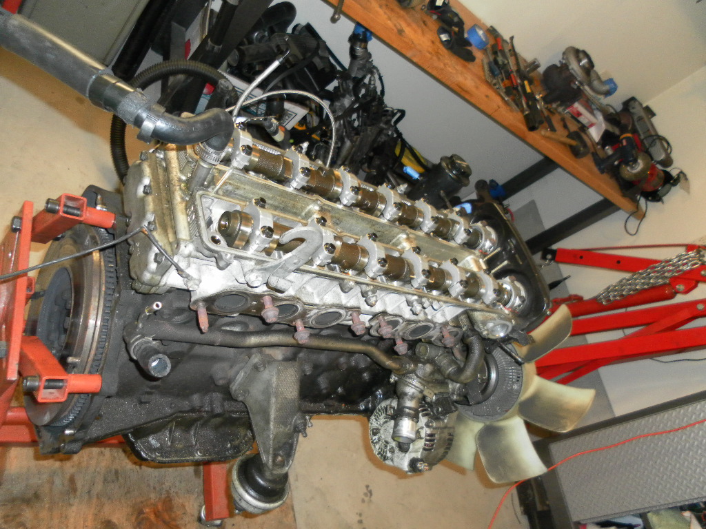

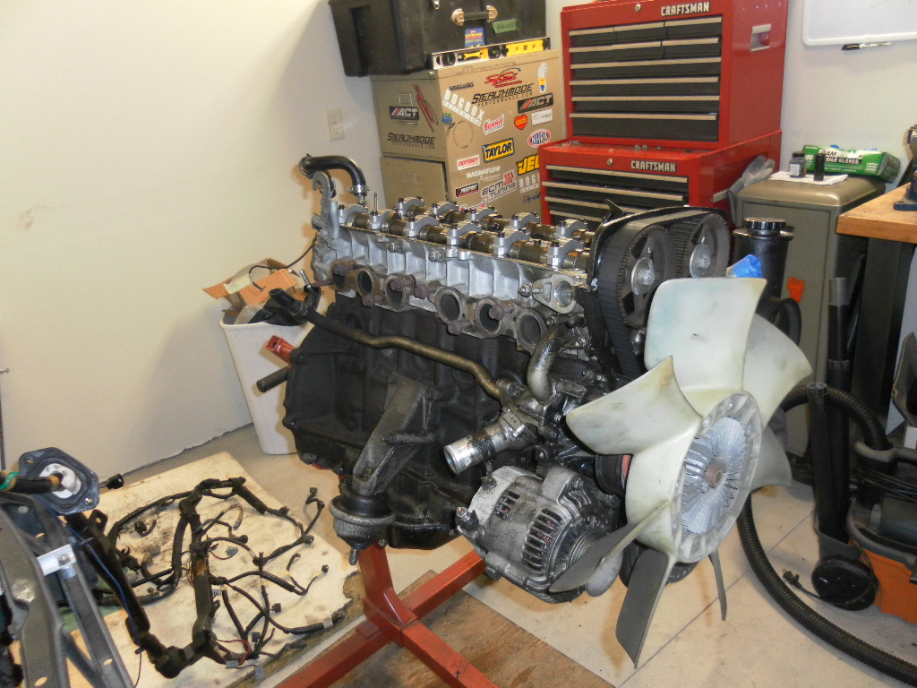

Rideskinz wrote back and said that's how they package all poly stuff because it will return to normal shape once it reaches a more normal temperature. Well he was right, the lip is sitting in the room and looks normal! So that's good

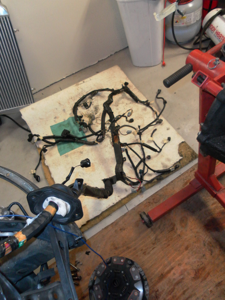

Went and worked on the motor for a couple hours today. It's taking me awhile since I'm new to this thing. The wire harness is a god aweful mess, but I got it all disconnected and out of the way. Intake and exhaust manifolds are off. Fuel rail off. Valve covers off. Serpentine belt off.
So at this point, I guess I need to figure out how the timing belt works and what all it takes to get that thing off. Seems like I'll have to remove a bunch of shit to get the cover off. Then take the cams out, head bolts off, and that should be it I think.
Once the head is off I plan on calling up Northern Cylinder Head in Andover to see if they'll go ahead and clean it up, put new valve seals, valve springs, and cams in for me (and shim). Nice little tin shed po-dunk feeling shop that's done a lot of head work for me on my DSM in the past!
So that's it for now. here's a couple pics.

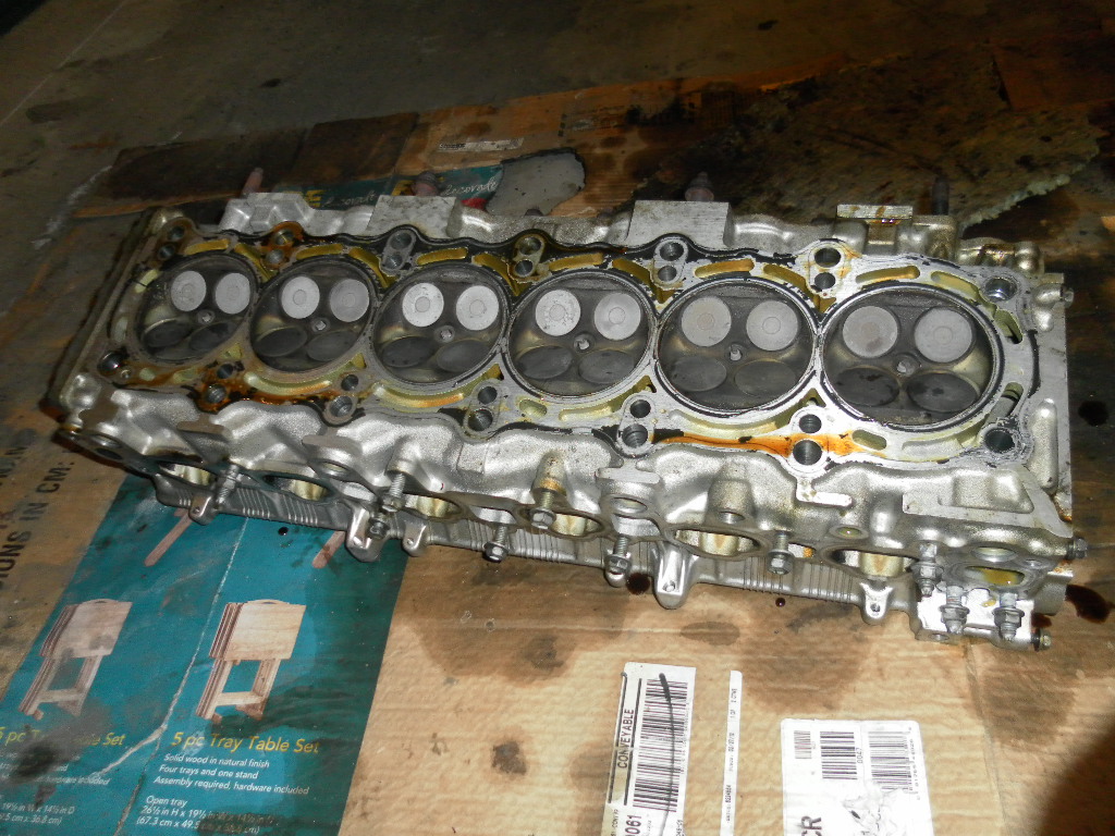

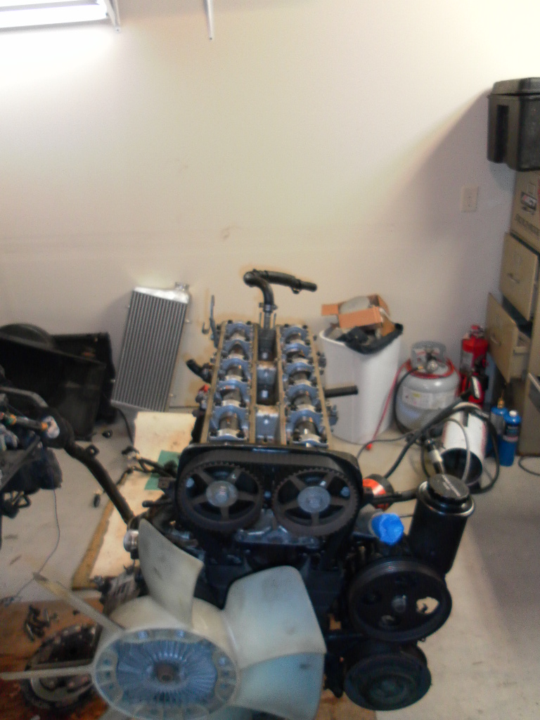

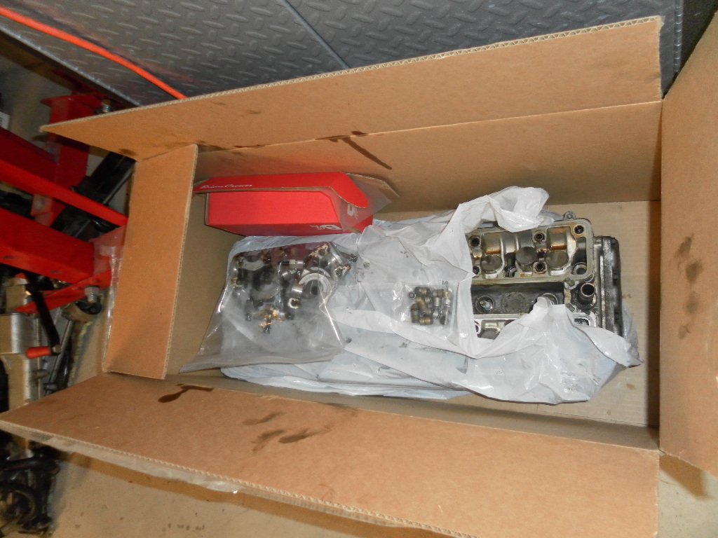

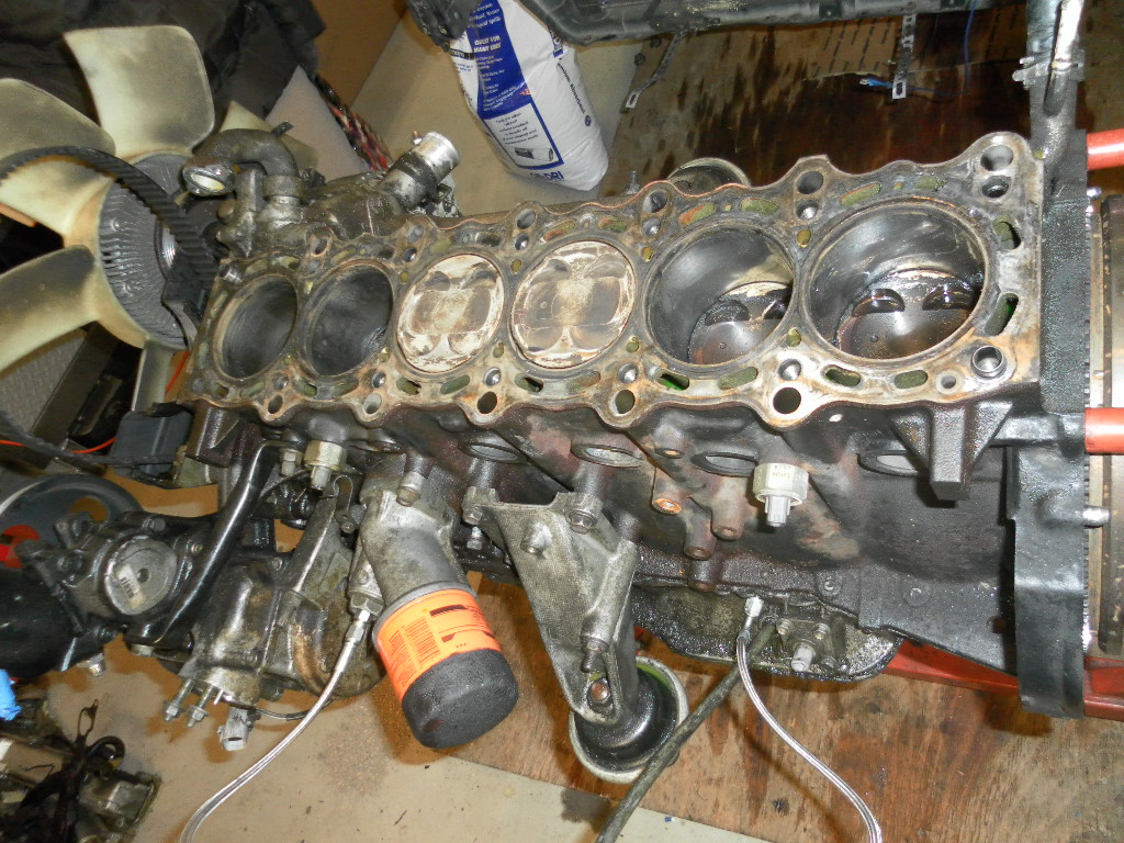

Got the head off. I have it all boxed up along with the new BC springs, and new stem seals. Just waiting for the new cams to arrive and then will be delivering it to the shop to get worked.
Engine looks pretty good. Going to try and clean some of the crud off the tops of the pistons. Cleaned of the middle two with a little brake cleaner and paper towel. Will move onto the other 4 another day.

Old 01-25-2013   #794
Murlo26
Murlo26's Avatar
Join Date: Dec 2009
Location: Lino Lakes
Drives: 17 Honda Accord
Posts: 4,041
Re: Project Lex
Mmmm, I want 6 of them! Nice, can't wait to see this back up and running tip top. Good work.

Got the head off. I have it all boxed up along with the new BC springs, and new stem seals. Just waiting for the new cams to arrive and then will be delivering it to the shop to get worked..
I thought you were a do it yourselfer? Or are you having them do a valve job?
dsmolition is offline   Reply With Quote
Old 01-25-2013   #796
Re: Project Lex
Having them clean it up. Check to see if anything looks old/worn such as guides and what not. If everything looks good, they will be installing new valve stem seals, the new BC springs, and I will have them shim for the new cams.
I've never done much internal head work (valves, seals, springs), and I don't have the tools for it. So I source that kinda stuff out.

Think I found my mysterious oil leak. Shouldn't there be more than 1 bolt holding the upper oil pan on?

1 out of 4 isn't bad, looks like its cracked on that front side.
