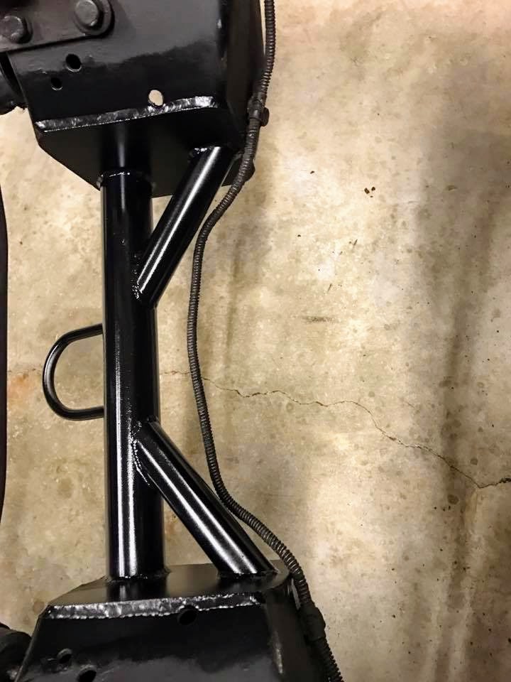

That thing looks bad ass from the rear with those wide tires. Nice frame work too. I've got a 66 chevy caprice that had a frame crack in the belly that made my bb sage down, I should have fixed it like you did!
