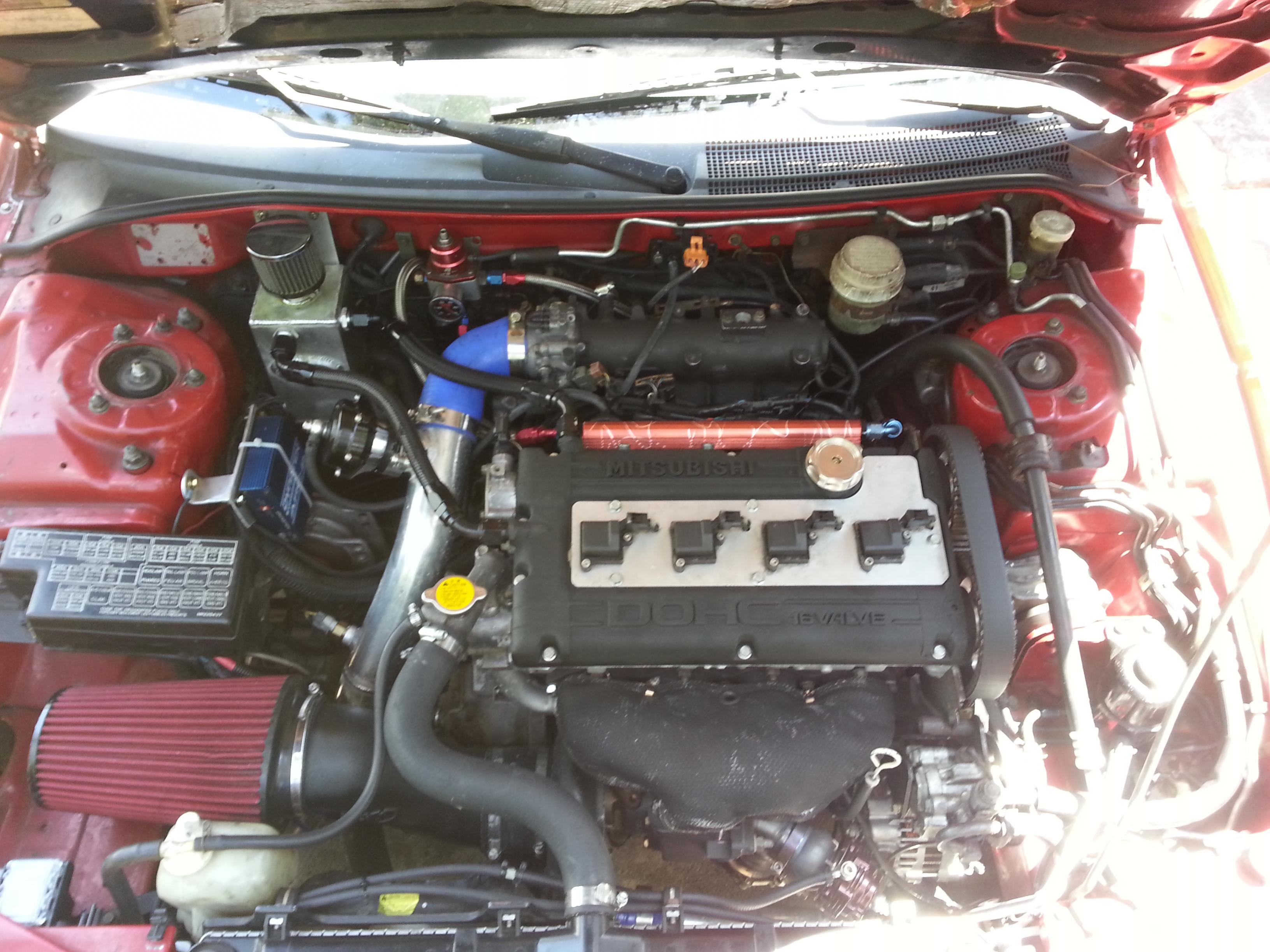

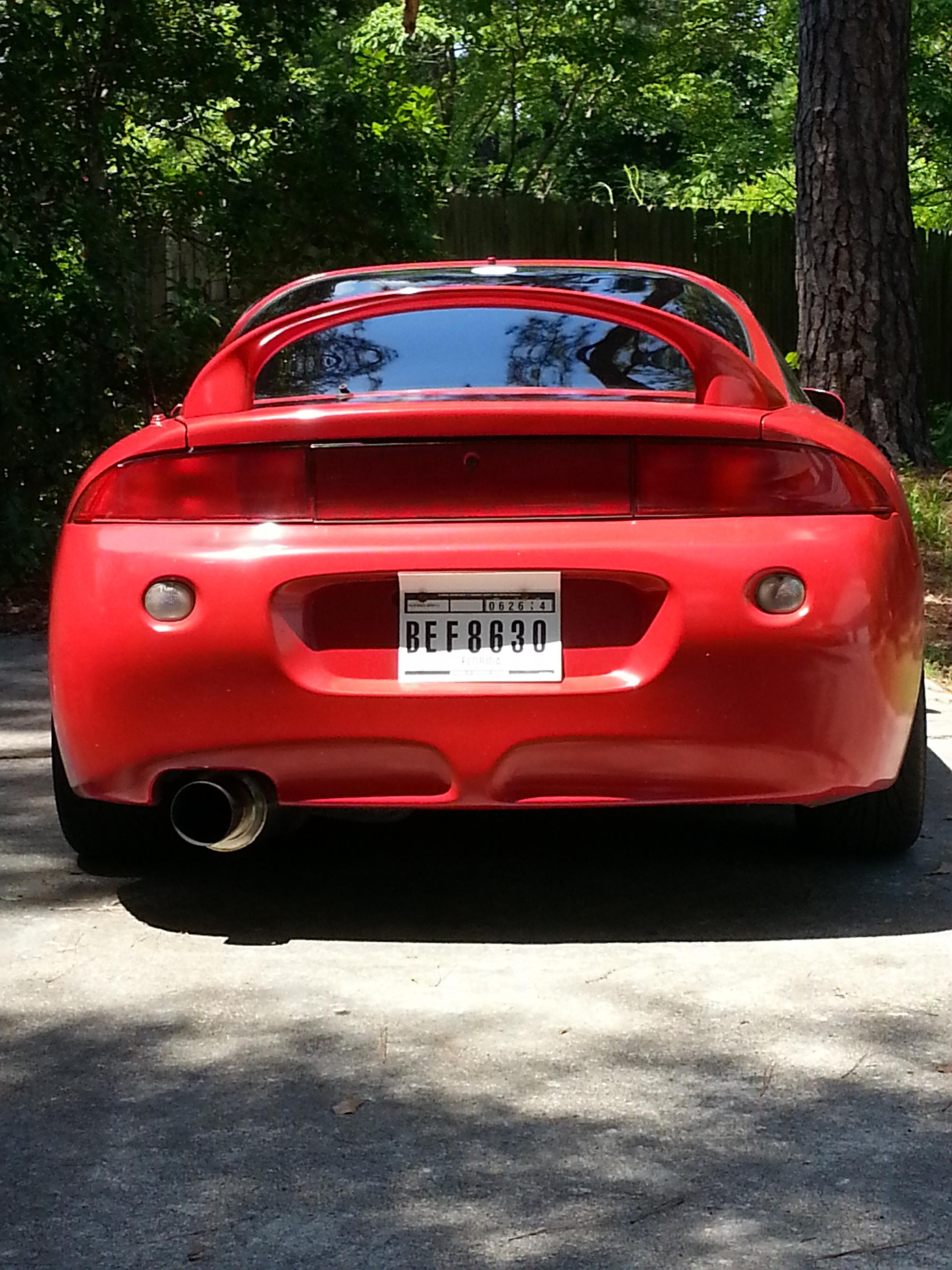

here are some pictures
ID:	14463   Click image for larger version
ID:	14464   Click image for larger version
