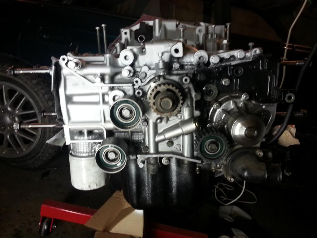

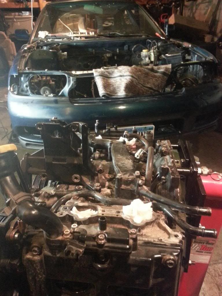

Got the motor pulled last night. I couldn't believe how easy it was to get out. Once I got it unbolted from the transmission and realized there was only one bolt per lower mount I cracked the beers open and got a little sidetracked. Today will be spent getting the head clearances figured out, disassembling the brakes, putting my short shifter in and re-painting the block black.

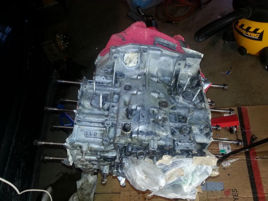

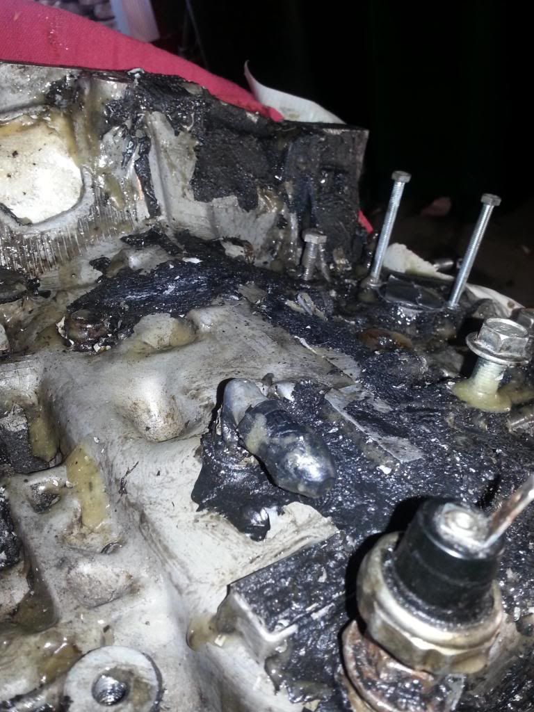

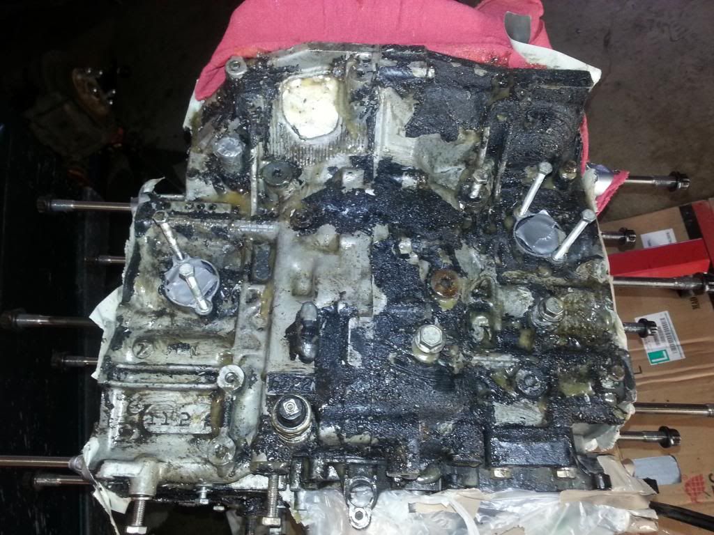

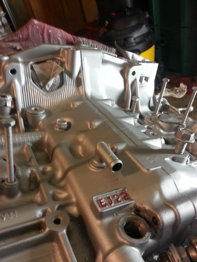

I spent most of the day hanging out in the garage. I started picking tools up, one thing led to another and I ended up pulling the n/a heads off, discovered I had headgaskets as thick as waffles, stripped the old chipped black paint off and shot it with some super high-temp silver paint.
Before
During
After
I was thinking about how well my fuel setup would handle e85 and I came to the conclusion that the best way to go would be to convert to top feed injectors. From what I hear, side feed style injectors get pretty temperamental when the size gets bigger than 850cc. By converting to top feed I'll have a more choices and will be able to run 1000cc+ with no issues.

Do you remember if it was for the 22T? or the 25D? The 22E gaskets I bought are MLS, but are not NEARLY as thick as the ones that came out. I never had issues with the gaskets I pulled off, and like the little extra height it provides. Even with such a thick gasket, the timing marks lined up the way they should. The .05" compressed thickness the EJ22E MLS gasket provides should be enough for the valves to clear the pistons with stock cams, but am concerned the extra lift from upgraded cams will cause issues with the thinner MLS gaskets I bought from Subaru.

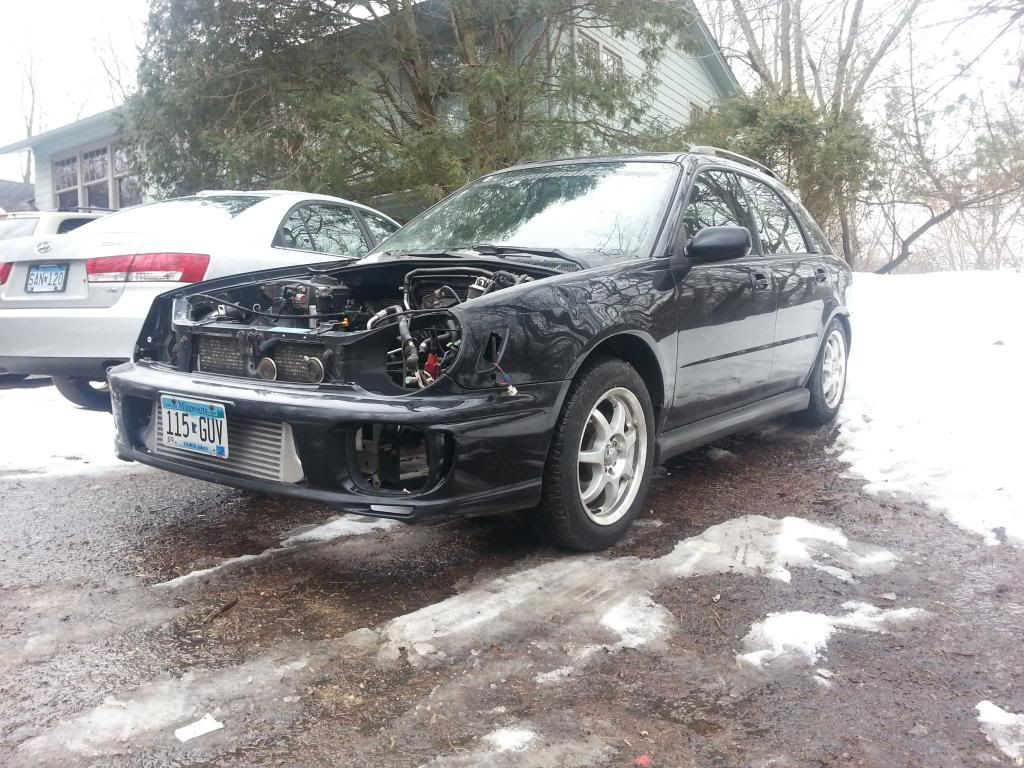

Got a new addition to the family today. Thanks again, Ryan!
The plan is to swap all the wiring and interior from the WRX to the Legacy. Once the Legacy is tuned I'll start piecing together stock parts for the wagon. Use the wagon as my DD, and sell my TSX. Ridding me of an awful car payment.
If time permits, I hope to have it swapped over by next Sunday. Progress pictures to come!

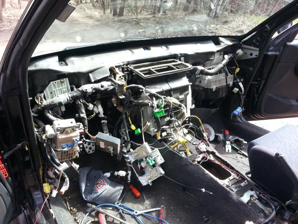

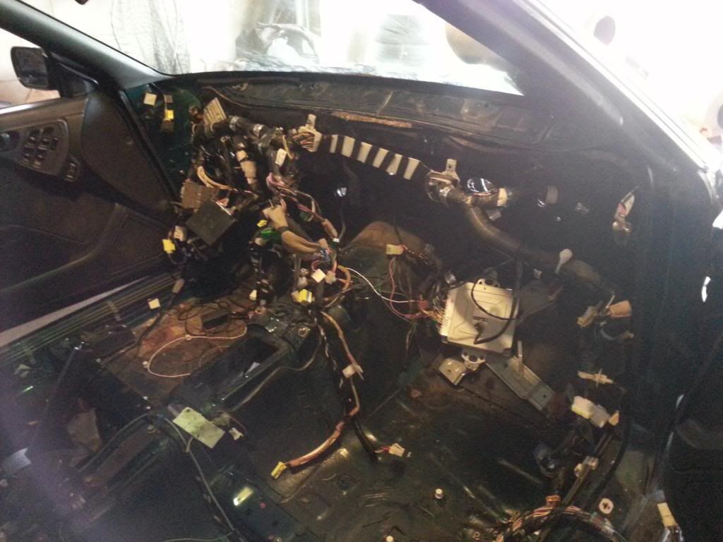

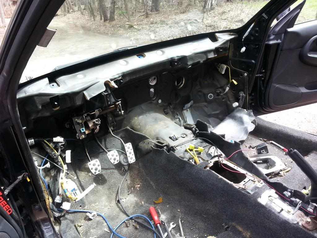

Re: Project Slowbaru

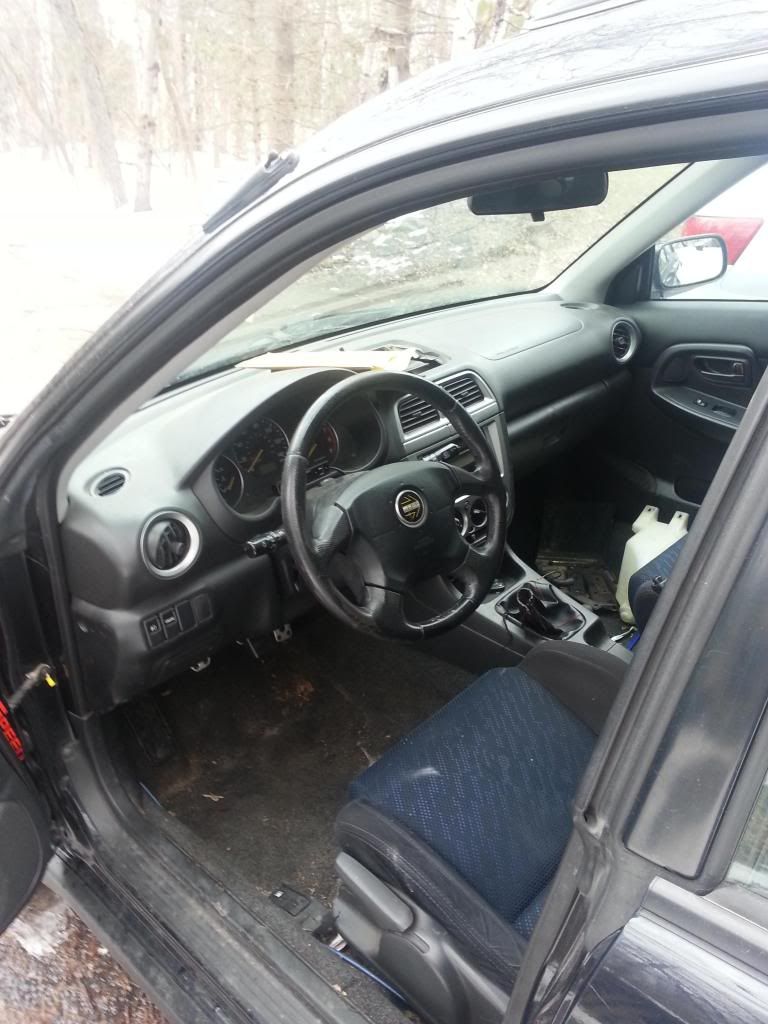

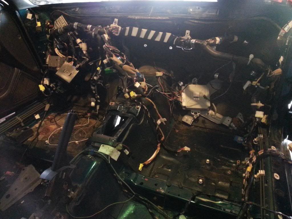

So I finally got some work done on the Slowbaru. I'm hoping to slowly chip away at the door wiring this week, and have the interior back in the Legacy by next Sunday. Once that's done I just have to button up the motor!
WRX before
During
After
The dash beams are nearly identical. I'll have trim the section holding the hood prop handle, but I won't need that as the Legacy's mount differently.
While I was quickly looking at the the fitment I did notice a ground or two I'll have to extend or find an alternate spot for. But the wiring from the WRX fits like a charm.
I will be using the WRX dash beam, pad, gauge cluster, steering column and pedals. I will most likely keep the Legacy door cards and just rewire the switches. It will be less work than making the WRX door cards fit.
