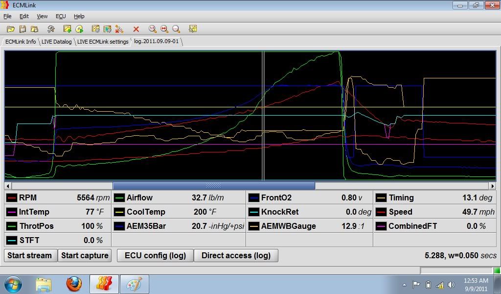

I got the 3582R on tonight. I'm thinking 1.06 T3 was the wrong way to go. But for anyone interested in spool time...
