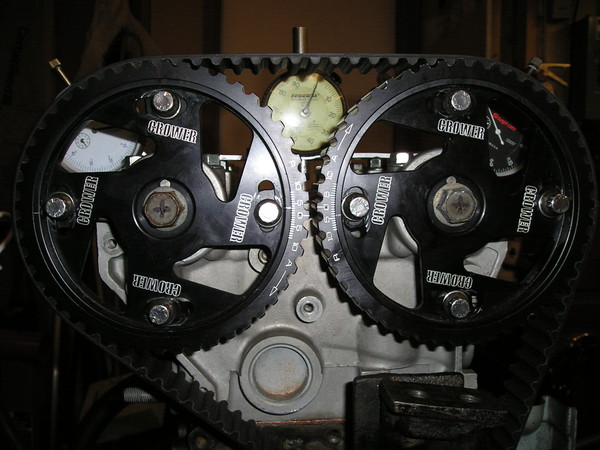

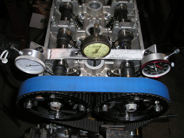

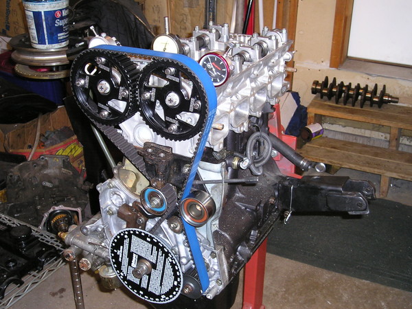

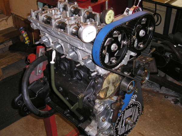

I made a bracket to hold all 3 dial indicators in the right spot so degreeing will be a lot easier and quicker in the future.
Close up at #1 TDC and both valves closed
With the Crower cam gears there is no real 0 marks and after all the decking on the block and head this is close to 0, if I run out of adjustment I would need to skip the belt 1 tooth either way on the intake and exhaust.
As it sits right now I can retard the cams a lot, but I do not have hardly any room for advancing the cams, the intake cam is close to hitting the piston when its at 0 and I have the intake retarded 8 deg and the exhaust retarded 6 deg (crank degrees). I know how close the valves are to the piston so I will play around with the cam gears on the engine dyno and see what it likes. I am looking at making the lob seperation higher then it is on the cam card and higher then it was before to help make power up top. Before the lobe seperation was about 104 deg and with were the cams sit now that number is about 110 deg.

Looks good John. So you are going for more than 110 lobe separation? I wouldn't advise over 114 as we might have serious idle issues with those high of a cam and the 1600's. We can play with injector angle time to try to bring it into check, but I'd say keep it wide enough to give room to mess with on the dyno to make power, without having to worry about fuel washing out the exhaust.

You can run a 13.99 or something with passengers, so the plan would be to run with 4 people the first time down the track and see what it can do. I would like to have all the bugs worked out before the track day, at least as many as possible. As for the cams, the cam card says they should be at a 104 lob separation, that is about what they were before. I have them set to 110 right now I doubt it will need to be higher, but it can go lower if needed.
