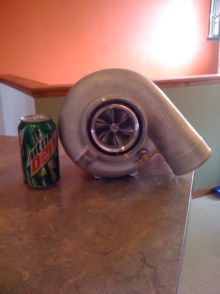

03-13-2010
#77
Boost Spike
Posts: 1,116
Re: Progress since last year
Ordered on Monday, and it showed up on Friday.
03-14-2010
#78
No Mt. Dew can no kare.
03-15-2010
#79
Boost Spike
Posts: 1,116
Dew the DEW!!
